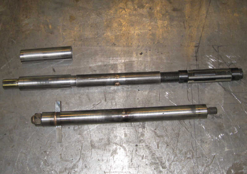

Delrin rear bushing cutting tools
Top: Sleeve that fits an already reamed bushing
Center: Reamer with long shaft and sleeve that fits the unreamed bushing in the opposite end of the trailing arm. At the left end a socket is welded to the shaft to turn the reamer.
The rosette welds hold short pins that capture the square end of the reamer but allow it to be removed as needed.
Bottom: Face cutting tool to precisely adjust the end play of a pivot shaft in the bushings
