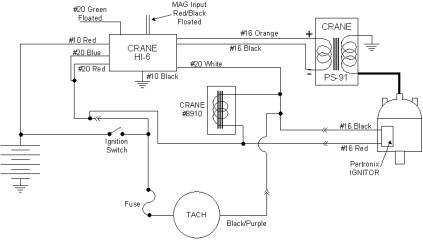

I've got a 2056 with cam and Webers. An electronic point module and the Crane HI-6/PS-91 each made a significant diference to the running of the car. When I drew this up I was still using the 009 distributor that the PO installed. Since replaced with the original 2.0 distributor, but haven't updated the drawing.
