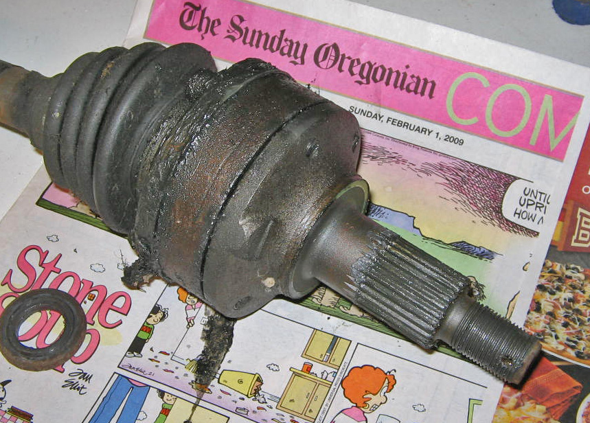

I had to spend some today to see what I've got... I took Eric's advice with the disk-in-the-vice technique and heat. My impact wrench loosened the axle nut without too much trouble. I was pretty surprised.
I tapped the stub axle and out came.... what I believe is a 914/6 stub axle! 28 splines, sure looks like one, but I've only seen them in pictures! Can anyone confirm?

Eric_Shea   Something on those stub axles doesn't look fac...   Feb 15 2009, 05:05 PM
MrKona   Something on those stub axles doesn't look fa...   Feb 15 2009, 09:07 PM

zig-n-zag   The mittlemotor stubs I sold, seemed to have a thi...   Feb 15 2009, 06:56 PM
Eric_Shea   Here's a picture Andy posted in Reid's thr...   Feb 15 2009, 10:41 PM

kwales   Looking at the splines, there are two different ap...   Feb 22 2009, 10:04 AM
MrKona   Looking at the splines, there are two different a...   Feb 22 2009, 12:23 PM
