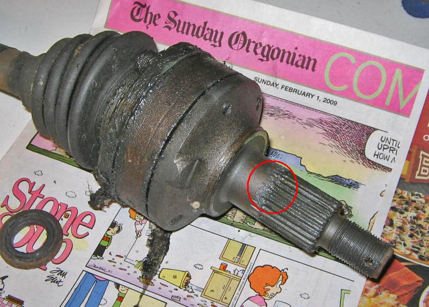

I had to spend some today to see what I've got... I took Eric's advice with the disk-in-the-vice technique and heat. My impact wrench loosened the axle nut without too much trouble. I was pretty surprised.
I tapped the stub axle and out came.... what I believe is a 914/6 stub axle! 28 splines, sure looks like one, but I've only seen them in pictures! Can anyone confirm?

QUOTE(MrKona @ Feb 15 2009, 11:47 AM) *
28 splines, yep, you're golden! Nice find. Looks like those things have taken some abuse, I wonder if this is cause for concern? "I" wonder, others here will just know. (IMG:style_emoticons/default/biggrin.gif)

Eric_Shea   Something on those stub axles doesn't look fac...   Feb 15 2009, 05:05 PM
MrKona   Something on those stub axles doesn't look fa...   Feb 15 2009, 09:07 PM
