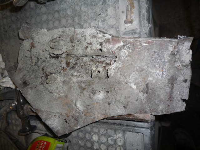

Well more progress now car very nearly stripped, not sure how to take out the metal dash frame but found a thread so Ill do that tomorrow. Welding (IMG:style_emoticons/default/welder.gif) starts next week. Here are some progress shots.
I hope it is of interest. (IMG:style_emoticons/default/smash.gif)
Roman (IMG:style_emoticons/default/mad.gif)

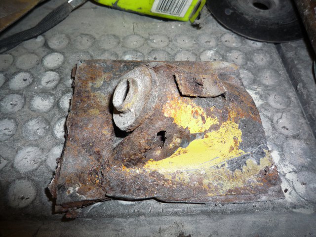

Even this is rotten
R

veltror   Is there anything ehich is not rotten on this? At ...   Jan 31 2009, 08:43 PM
