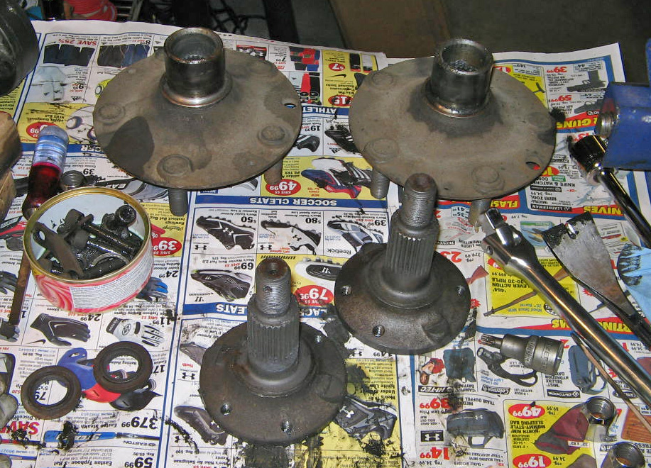

It's the rears that got my attention. The hubs are originally five lug, not four lug redrilled for five. The guy who sold them to me took them off a 914 he parted out a long time ago and has been storing them ever since for an eventual five lug conversion. He sold them as he has too many projects as is.
Unfortunately, I'm going to be gone for a few days and won't get a chance to dig into these until next weekend. I'm wondering if I may have acquired a set up with 914/6 stub axles. (IMG:style_emoticons/default/drooley.gif)

I've begun to disassemble the rear trailing arms. I drove out the hubs with a metal pipe and hammer, and then removed the stubs from the CVs. I had to figure out how to hold the axles to loosen the CV bolts with the axles removed from the car. I ended up bolting the already removed hubs to the disks, then clamping the disks in a vice, then fitting the stub inside the hub, which worked just fine.
All I can say is what a dirty, greasy, disgusting mess this is.

Eric_Shea   Something on those stub axles doesn't look fac...   Feb 15 2009, 05:05 PM
MrKona   Something on those stub axles doesn't look fa...   Feb 15 2009, 09:07 PM

zig-n-zag   The mittlemotor stubs I sold, seemed to have a thi...   Feb 15 2009, 06:56 PM
Eric_Shea   Here's a picture Andy posted in Reid's thr...   Feb 15 2009, 10:41 PM
