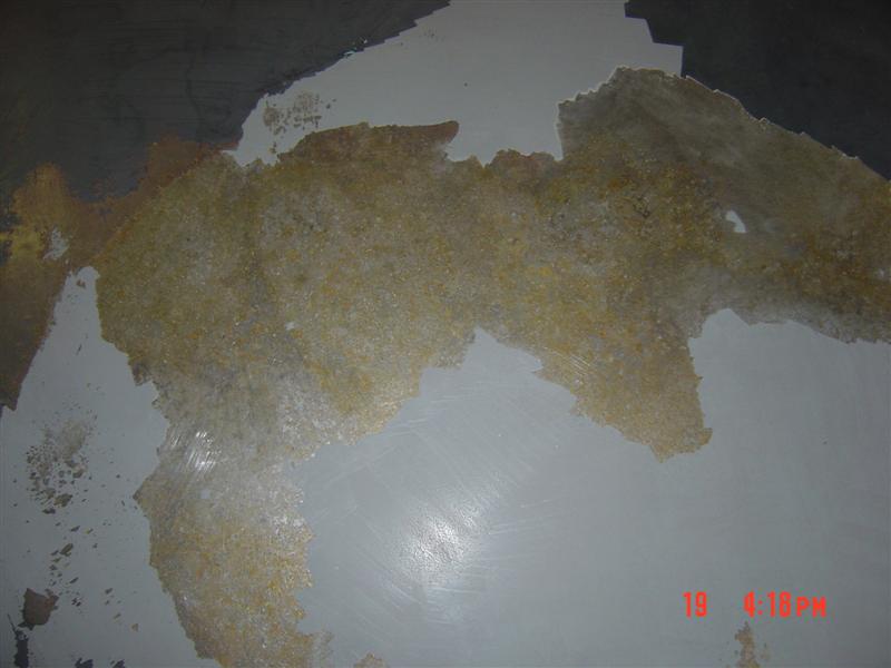

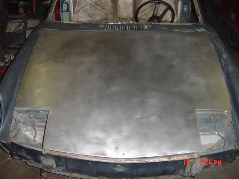

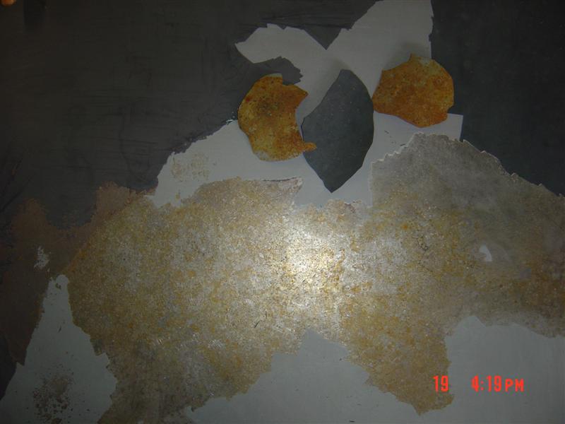

Guys I don't give a damn what your paint rep says DO NOT PAINT OVER FLASH RUST !!! This is what happens. I stripped close to half of this hood with a razor blade. (IMG:style_emoticons/default/dry.gif) The larger pieces are just a few that came off that way. Two are upside down so you can see the rust attatched to the paint. (IMG:style_emoticons/default/barf.gif)

QUOTE(scotty b @ Feb 19 2009, 04:02 PM) *
Alright, so whats your recommendation, wirebrush, rustmort(conversion), metal etch primer and then go from there???

Sand, metal etch primer, sealer, bondo, sealer, paint. I start stripping with 36 grit to speed things up, then finish sanding the panle clean with 80 grit. IMO 36 is too much gouge to start painting over. I like to knock that down with the 80. Etch primer is the BEST way but to keep costs down you can use the now popular epoxy primer. just talk to your paint rep about which product he recommends over top of bare metal. If the panel sits bare for a while make sure to run over it again wiuth the 80 grit on a da.
