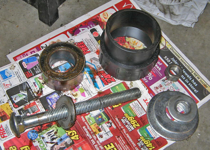

And the result! Held the big bolt with a Vice Grip, turned the nut, and the bearing came out like buttah!

Please post the specs of the items needed to fab this bearing puller?
Gud yob mon... (IMG:style_emoticons/default/biggrin.gif)
QUOTE(MrKona @ Feb 20 2009, 10:30 PM) *

MrKona   My homemade tool in action!   Feb 21 2009, 12:28 AM
MrKona   And the result! Held the big bolt with a Vice ...   Feb 21 2009, 12:30 AM
Jeff Bowlsby   Please post the specs of the items needed to fab t...   Feb 21 2009, 11:30 AM
MrKona   Please post the specs of the items needed to fab ...   Feb 21 2009, 12:36 PM
Jeff Bowlsby   Thanks Bryan! That saves me some time... [q...   Feb 21 2009, 10:21 PM
