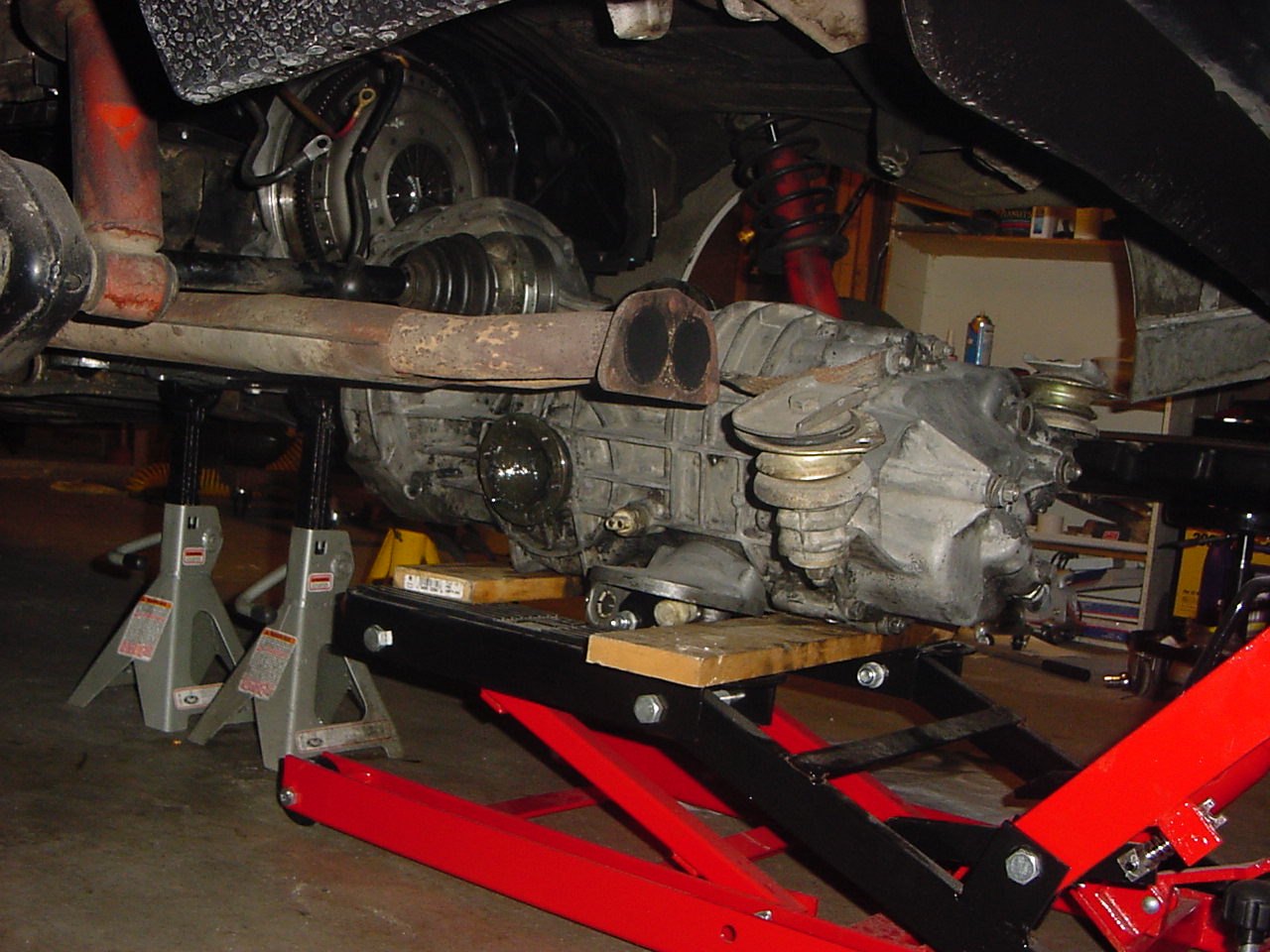

Andy, thanks for all the help. I got the seal in and tranny in. I used this motorcycle jack and it worked great.
