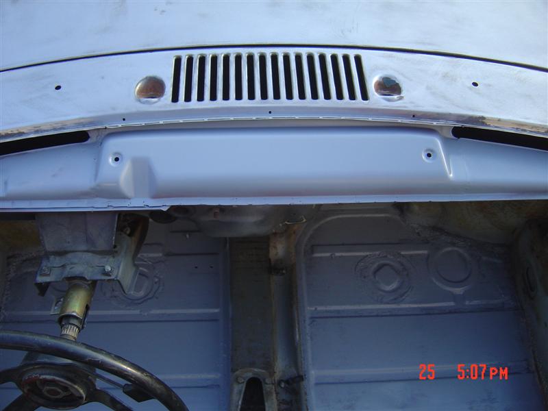

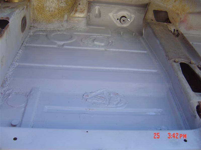

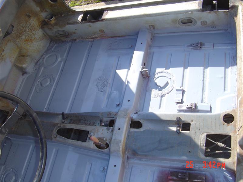

I hit the rusty spots on the floor with a wire brush, went over the whole thing with 150 grit, etched, and sealed it. Drivers rear will need some metal in it.
