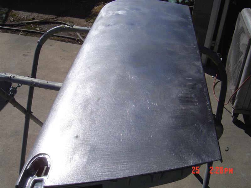

scotty b   FOUND IT !!! there's ALWAYS one so...   Feb 25 2009, 06:55 PM
scotty b   I hit the rusty spots on the floor with a wire bru...   Feb 25 2009, 06:57 PM
scotty b   Interesting door mod I unearthed <_< TOO MU...   Feb 25 2009, 06:59 PM
scotty b   These are the 2 oil cans in the door. I tried to f...   Feb 25 2009, 07:01 PM
scotty b   After a little help from my friends   Feb 25 2009, 07:03 PM
scotty b   The remnants of 3 hours of my day. I didn't ge...   Feb 25 2009, 07:04 PM

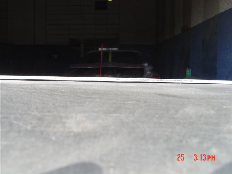

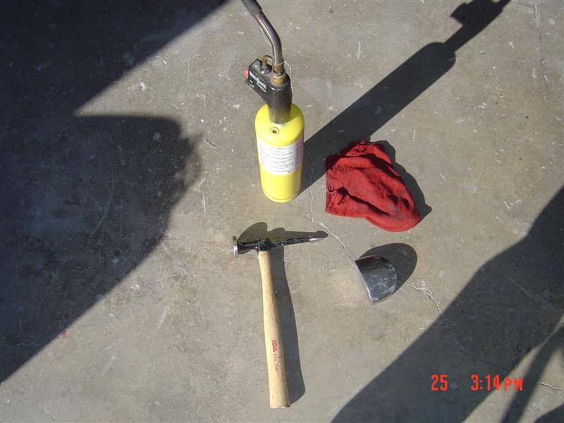

FourBlades   Scotty, Can you give us some tips on shrinking wi...   Feb 26 2009, 10:20 AM
Dr Evil   When you say "oil cans in the door", is ...   Feb 26 2009, 10:57 AM
davesprinkle   When you say "oil cans in the door", is...   Feb 26 2009, 12:43 PM
Dr Evil   When you say "oil cans in the door", i...   Feb 26 2009, 02:41 PM
Dr Evil   Tow dolly has been reserved and will be picked up ...   Feb 26 2009, 11:44 AM
scotty b   Dave hit it on the head. As for my method I just p...   Feb 26 2009, 07:49 PM
