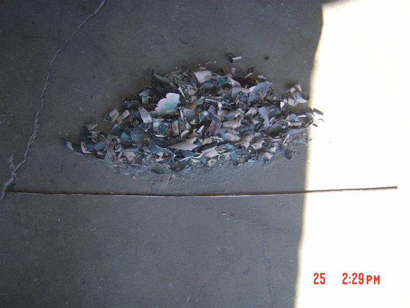

The remnants of 3 hours of my day. I didn't get any pics but I also stripped the roll bar ( one big dent ) both sail panels ( no issues ) and the cowl ( no issues )

scotty b   The remnants of 3 hours of my day. I didn't ge...   Feb 25 2009, 07:04 PM
