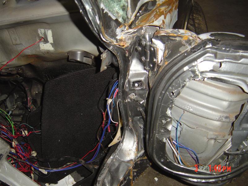

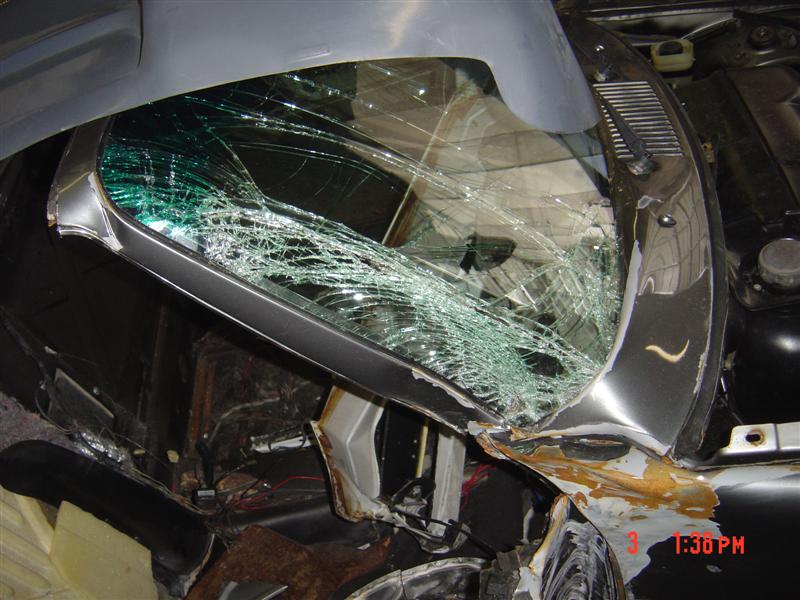

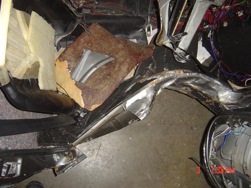

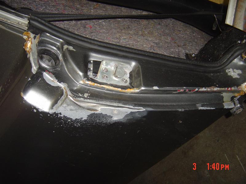

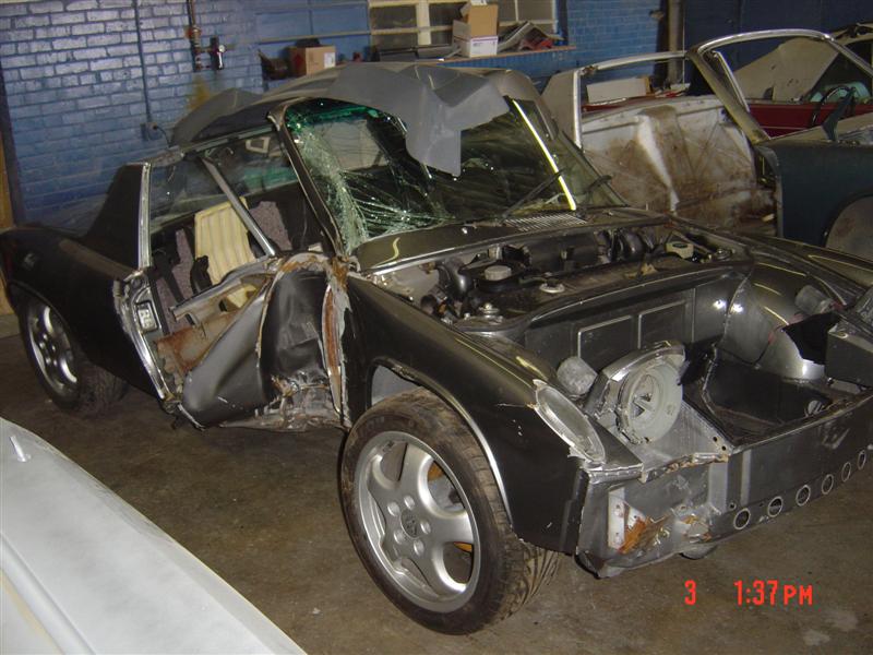

As most of you probably nkow Mike got the wreck down to me last weekend. I thought I'd post some pics of it and also to show you all how a car reacts, and transfers the impact during an accident.
Keep in mind as you look at these that this was a fairly low speed accident BUT it was against an immovable oblect, not another car that would have contibued to move after being struck.
