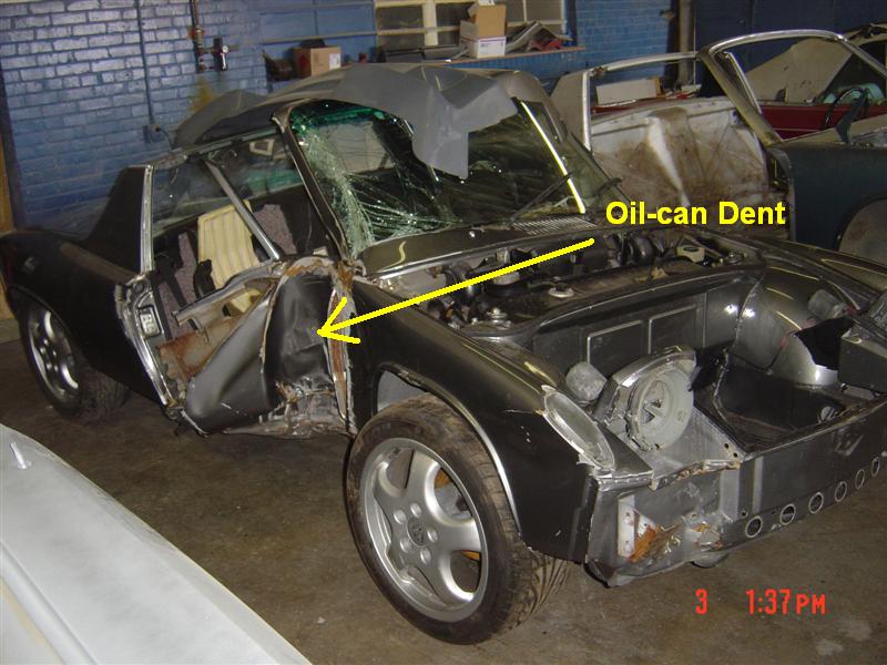

scotty b   Interesting door mod I unearthed <_< TOO MU...   Feb 25 2009, 06:59 PM
scotty b   These are the 2 oil cans in the door. I tried to f...   Feb 25 2009, 07:01 PM
scotty b   After a little help from my friends   Feb 25 2009, 07:03 PM

Dr Evil   When you say "oil cans in the door", is ...   Feb 26 2009, 10:57 AM
davesprinkle   When you say "oil cans in the door", is...   Feb 26 2009, 12:43 PM
Dr Evil   When you say "oil cans in the door", i...   Feb 26 2009, 02:41 PM

scotty b   Dave hit it on the head. As for my method I just p...   Feb 26 2009, 07:49 PM
