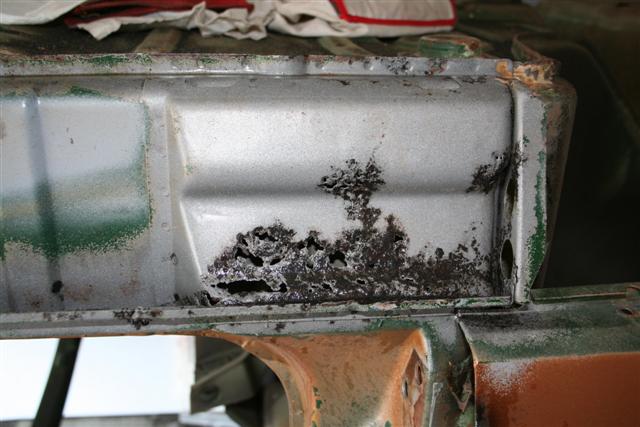

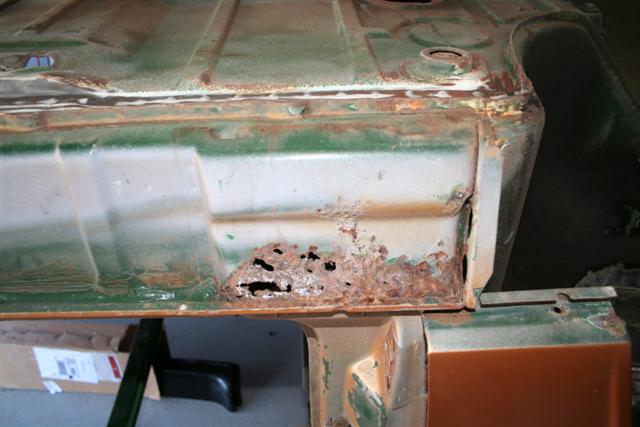

Car is upside down so this is driver side...
PO removed most of jack point tube and pyramid
Gotta fix the front as well
Quick media blasting to see extend of damage.

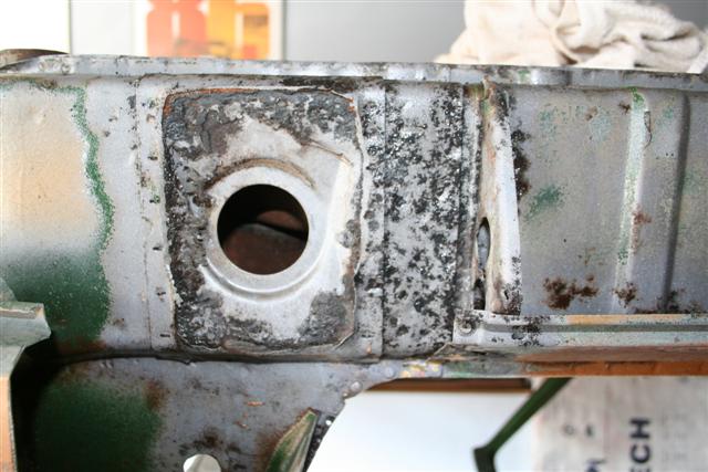

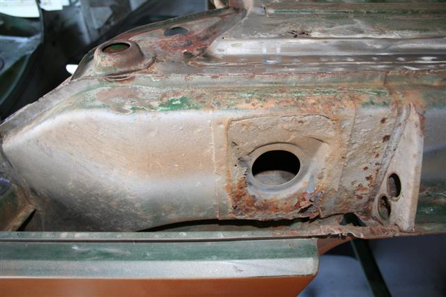

Same for front
Drill out spot welds of whats left of the pyramid
More media blasting

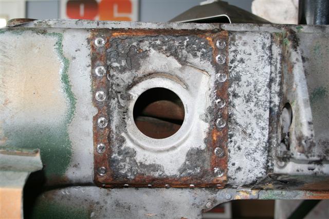

Richard Casto   Car is upside down so this is driver side... PO...   Mar 31 2009, 07:19 PM

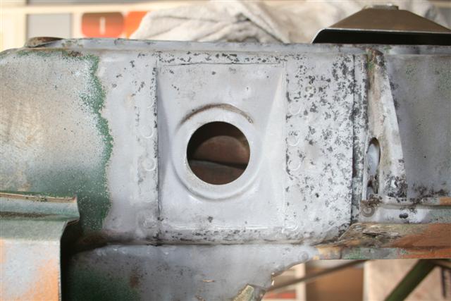

Richard Casto   Media blasted and treated with Metal Ready. I h...   Mar 31 2009, 07:24 PM
Richard Casto   All welded on. Fabrication takes a lot of...   Mar 31 2009, 07:29 PM
Richard Casto   Just need to grind down the welds and add in the...   Mar 31 2009, 07:35 PM
