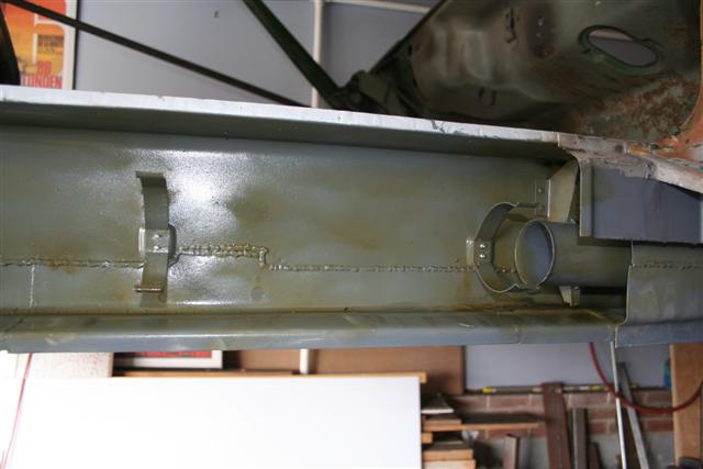

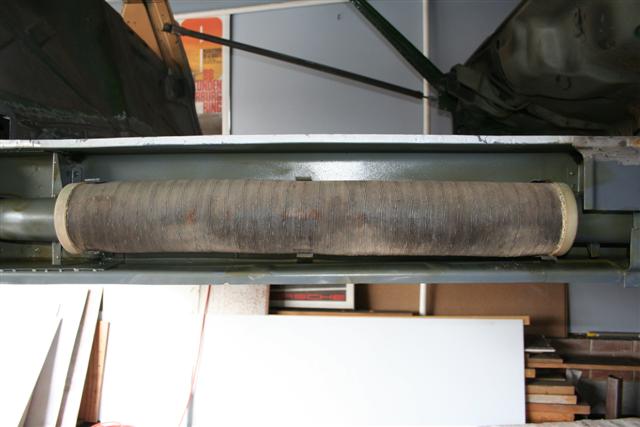

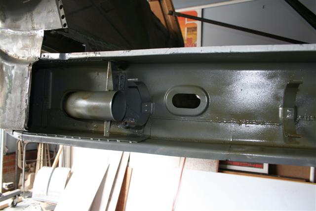

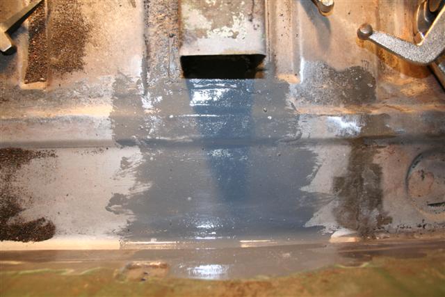

Media blasted and treated with Metal Ready. I have decided at this point I am going to remove and replace the driver side sill.
POR-15 on the inside of where I am welding back my crossmember on the passenger side.
Replicated the half-moon bump out. Getting ready to weld outside of longitudinal back into place
Spray inside with CRC anti-corrosion. I will probably go back and do a proper cavity wax at some point.
Heater tube back in place.
