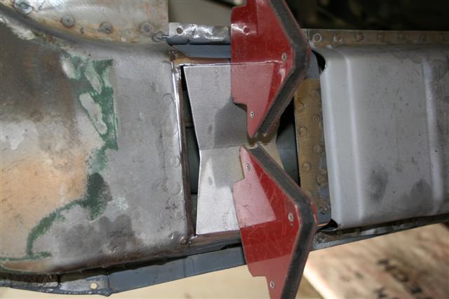

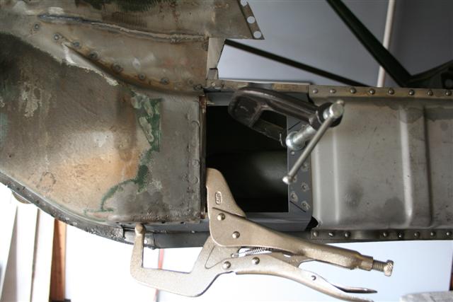

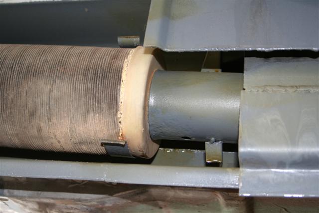

All welded on. Fabrication takes a lot of time. Welding it together goes quick!
Now for the double wall section where the jack receiver is located.
Replicate the bump in recess for the receiver tube. This is just the inner layer of the double wall

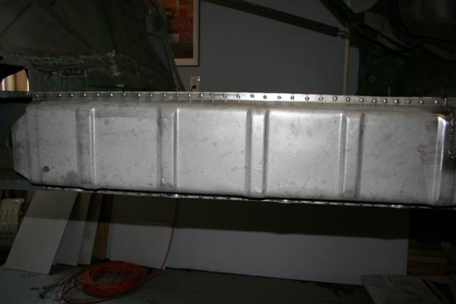

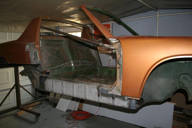

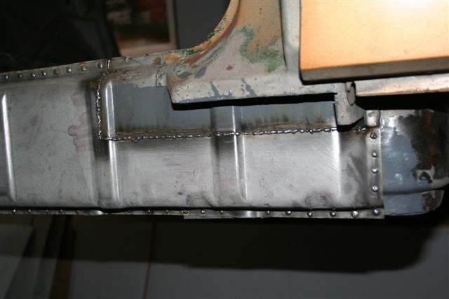

Richard Casto   Ok, it's been months since I have updated this...   Mar 31 2009, 07:14 PM
Richard Casto   Car is upside down so this is driver side... PO...   Mar 31 2009, 07:19 PM
Richard Casto   Media blasted and treated with Metal Ready. I h...   Mar 31 2009, 07:24 PM
Richard Casto   All welded on. Fabrication takes a lot of...   Mar 31 2009, 07:29 PM
Richard Casto   Just need to grind down the welds and add in the...   Mar 31 2009, 07:35 PM
Richard Casto   About 1/2 done with my welding. While the c...   Mar 31 2009, 07:41 PM
Richard Casto   Mostly welded and about 90% ground down. Just m...   Mar 31 2009, 07:46 PM
Richard Casto   Well that is it for now. I am going to continue t...   Mar 31 2009, 07:50 PM
