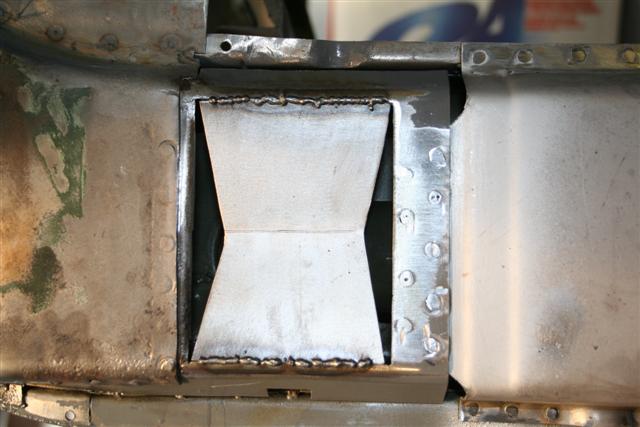

Just need to grind down the welds and add in the rest of the inner layer

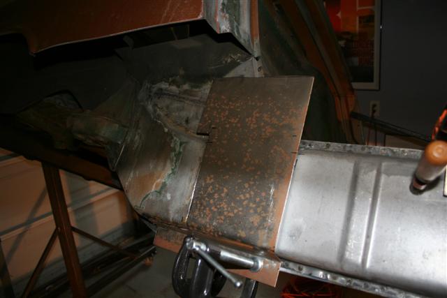

First two bends on the fabrication of the outside layer

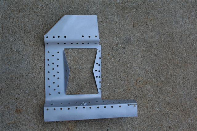

Inside layer just about all ready to go. I painted it with weldable primer right after this.

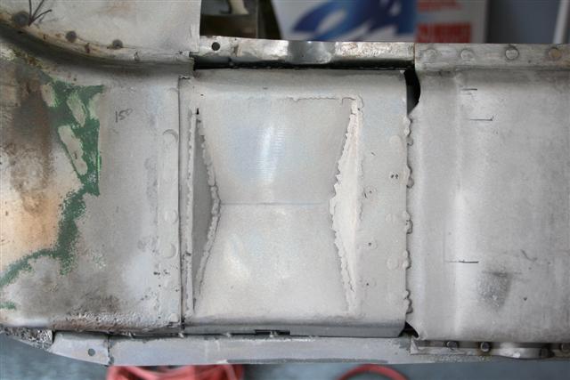

Here is the main section for the outside. It's ready and painted. Just need to weld.

Richard Casto   Mostly welded and about 90% ground down. Just m...   Mar 31 2009, 07:46 PM

dlo914   Nice welds! :) ...what are you using? I'm ...   Apr 1 2009, 09:38 PM
