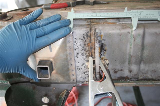

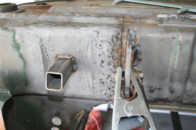

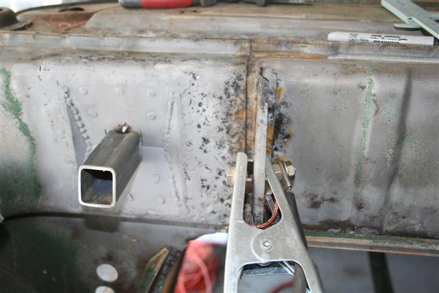

Jumping ahead a bit, I have prepared both the driver and passenger side for the receiver tube. I measured (based upon location of previous pyramid) and tacked into place.
Double check that it's in the right place and then...
Finish welding the tube

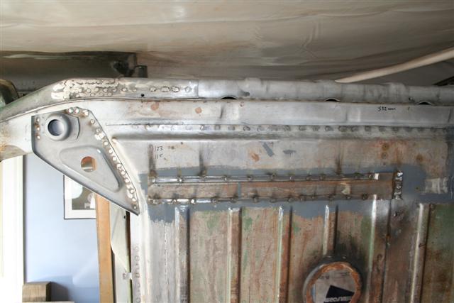

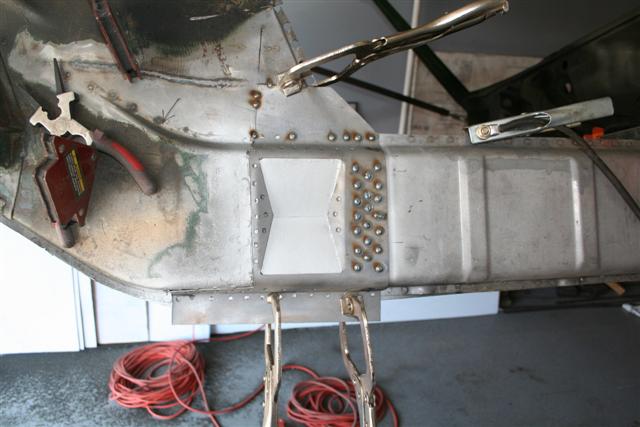

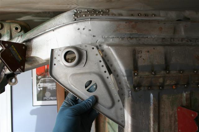

Richard Casto   About 1/2 done with my welding. While the c...   Mar 31 2009, 07:41 PM
Richard Casto   Mostly welded and about 90% ground down. Just m...   Mar 31 2009, 07:46 PM
