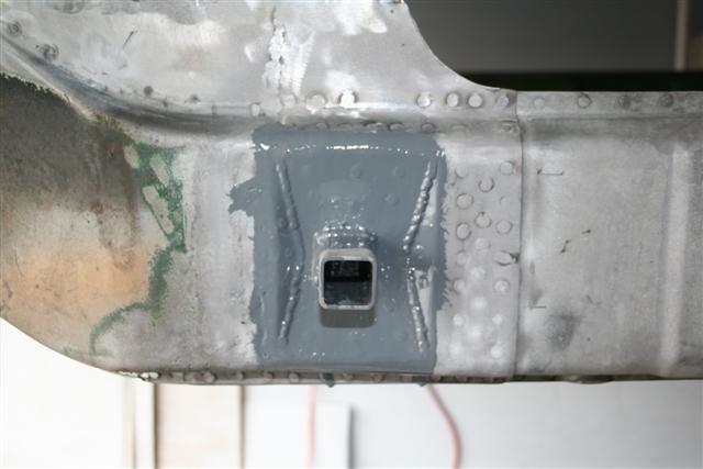

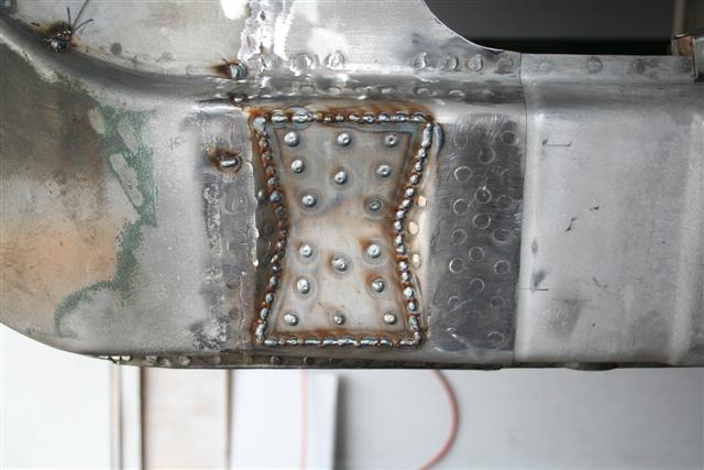

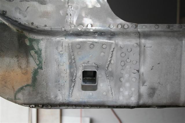

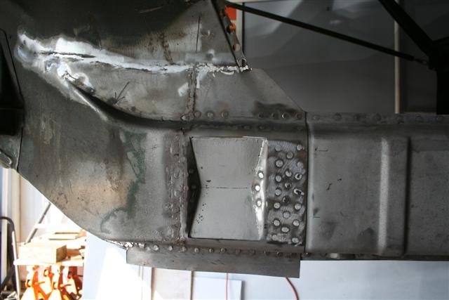

Mostly welded and about 90% ground down. Just missing the bow-tie.
Note this is not a perfect replica of the shape of the factory stamping. They have a flat spot that you weld the tub to. I decided it was going to be too difficut to replace that flat spot and was not going to be seen anyhow.
Bow-tie in place. This is the reverse pyramid that creates about a 13mm recess for the receiver tube.

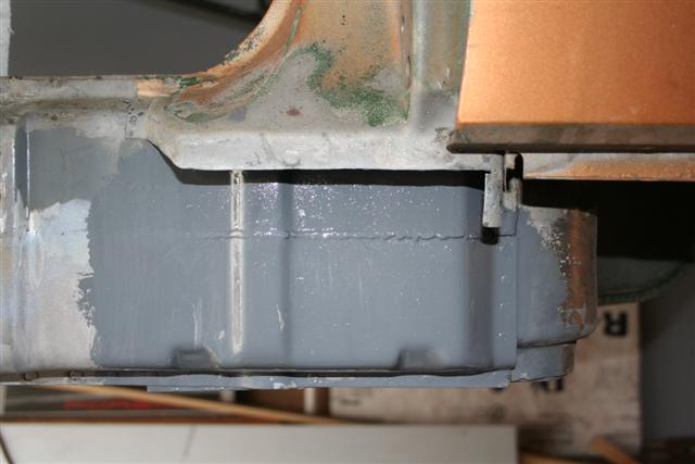

Tube welded in, welds ground down, media blasted and treated with Metal Ready.
POR-15 on the inside. I will grind off some of the POR-15 for my rosette welds on the pyramid
Same for the front. I need to fabricate the section that covers this.
