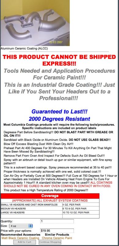

You want Ceramic Coating (Jet Hot) not powder coat. I've had a local company Ceramic coat and in the past have used Jet-Hot the company. I can say that I had a 914 melt into the ground and the only thing left was my Jet-Hot'd coated Kerry Hunter headers. There was nothing else left - nothing, no motor, no tranny, no wheels, no steering wheel - just the headers and they were in perfect shape. T.C. This is ceramic, not powder coat. The only purpose of the powdercoat oven is to give the product an initial set. |
