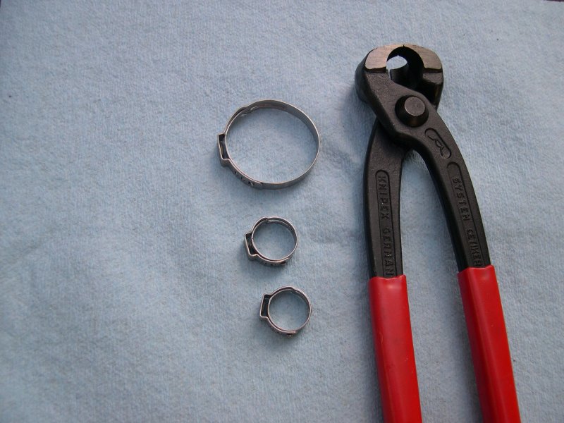

Back to an earlier unanswered question: How do you duplicate the crimped connection to the injector?
davesprinkle
post Apr 6 2009, 05:20 PM
Posts: 720
Joined: 13-October 04
From: Berkeley, CA
Member No.: 2,943
QUOTE(Porsche Rescue @ Mar 9 2007, 09:29 PM) *
Oetiker makes the crimp-on clamps. Every fuel fitting in my entire car, save the two on the fuel filter, is done with these clamps. Due to the different sized lines, you'll need two different clamps. The clamps and the tool are available from McMaster-Carr.
12.3 to 14.5mm clamp McMaster #52545K53 $8.48/25
13.2 to 15.7mm clamp McMaster #52545K54 $8.53/25
side-jaw pincer tool McMaster #6541K69 $24.63/ea
You CW types should be aware that the PNs above are for clamps that are similar to but not exactly the same as the factory clamps. They differ slightly to allow more consistent radial clamping load under the clamping "ear". I believe, though, that McMaster may also sell the std type clamp. Here's a pic. The big size is what I use for the CV boots.
