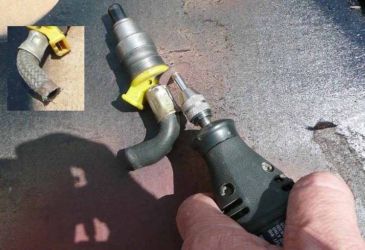

The clamps on the injectors in our '71 looked different than those. Some of them had the cloth covered hoses, and some just rubber hoses too, so I don't know if they were OEM or not (IMG:style_emoticons/default/confused24.gif)
I used a Dremel tool to cut the 'original'? clamps off when it was time to replace the old hoses.
I didn't even bother to look for that type ... just used the worm screw type (they were German replacement clamps though) ... the same type that were on all the other hoses (at the pump, pressure regulator, etc.)
