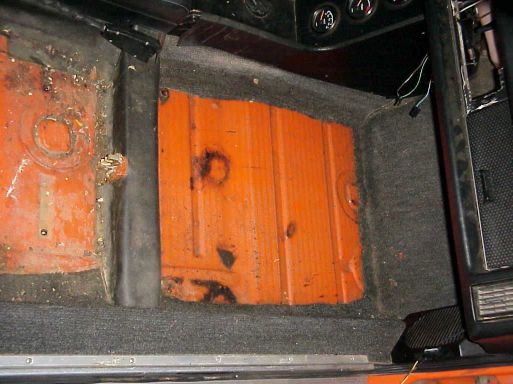

He took the seat out for pics so I could see that there was a rust spot on the floorboards. The seat is installed now, though.
There cant possibly be more wierdos here then the fiat boards... Thanks for the support! Attached thumbnail(s) ![]() |
