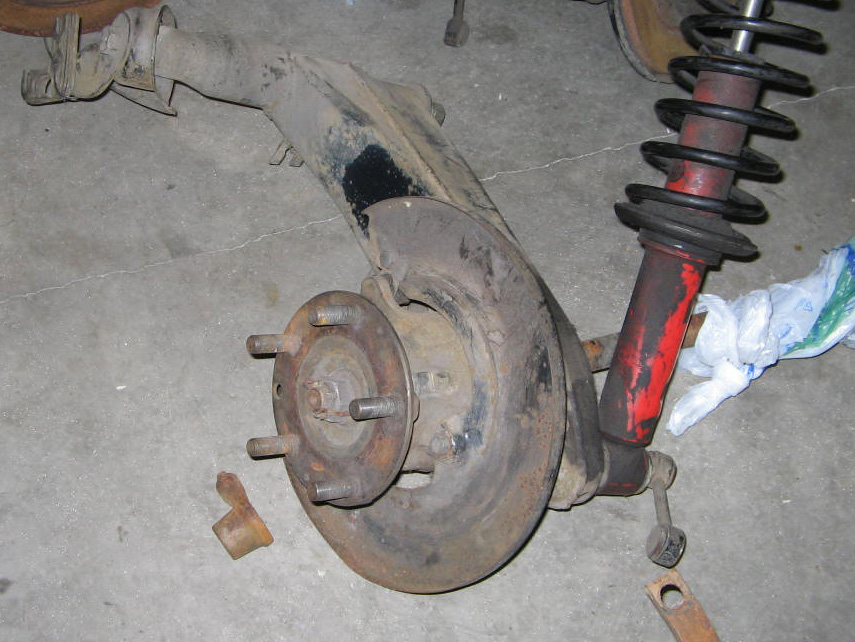

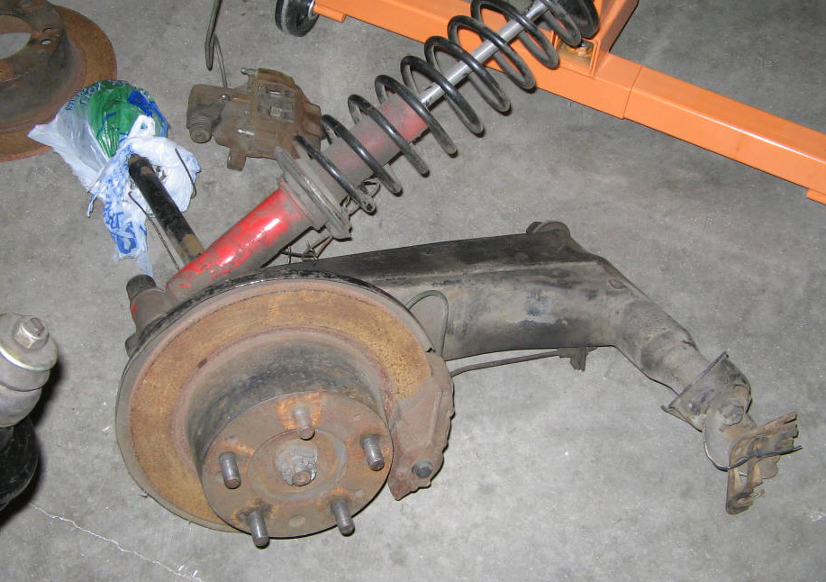

I bought a five lug set up today from a local guy off craigslist. The front is a Boge set up with 3" spacing and M-calipers. I already have a pair so I will most likely be selling these off in the near future.
It's the rears that got my attention. The hubs are originally five lug, not four lug redrilled for five. The guy who sold them to me took them off a 914 he parted out a long time ago and has been storing them ever since for an eventual five lug conversion. He sold them as he has too many projects as is.
Unfortunately, I'm going to be gone for a few days and won't get a chance to dig into these until next weekend. I'm wondering if I may have acquired a set up with 914/6 stub axles. (IMG:style_emoticons/default/drooley.gif)
By the way, anyone have a suggestion on how to remove the big castle nut with the suspension off the car? (IMG:style_emoticons/default/confused24.gif)
