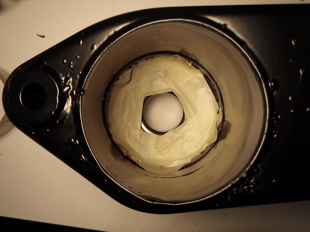

I installed the hubs today using the same screw mechanism I used to pull the original bearings. Worked great.
Started out with nice clean hubs..
Taped up the powder coated surface to avoid scratches.

MrKona   I installed the hubs today using the same screw me...   Apr 18 2009, 01:29 PM
MrKona   Laid a couple washers on the tape. The washer was ...   Apr 18 2009, 01:30 PM
MrKona   The "screw mechanism." Put a light coat ...   Apr 18 2009, 01:31 PM
MrKona   And the final result!   Apr 18 2009, 01:33 PM
