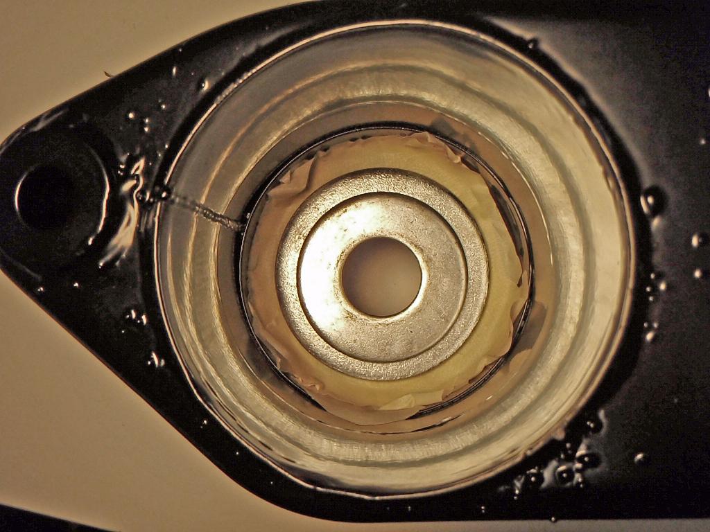

MrKona   I'm installing the rear bearings tonight. I st...   Apr 16 2009, 10:21 PM
charliew   If it's not too late. I have had real good luc...   Apr 18 2009, 09:47 AM
MrKona   If it's not too late. I have had real good lu...   Apr 18 2009, 01:25 PM
MrKona   I installed the hubs today using the same screw me...   Apr 18 2009, 01:29 PM
MrKona   Laid a couple washers on the tape. The washer was ...   Apr 18 2009, 01:30 PM
MrKona   The "screw mechanism." Put a light coat ...   Apr 18 2009, 01:31 PM
MrKona   And the final result!   Apr 18 2009, 01:33 PM
