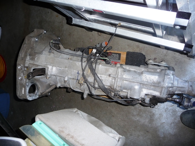

Suby 5 speed waiting for the Bremar conversion parts.
(Have to work some overtime soon...)

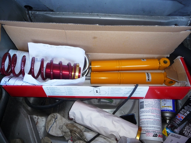

Other Koni shocks and Ground Control Goodies waiting for their turn to play!
