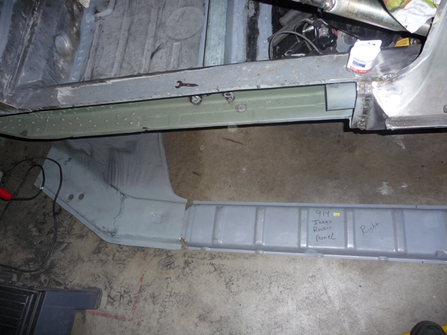

Zaney   After the passenger long was repaired on the inter...   Apr 24 2009, 10:23 AM
Zaney   Underneath, the seat rail reinforcements were repl...   Apr 24 2009, 10:29 AM

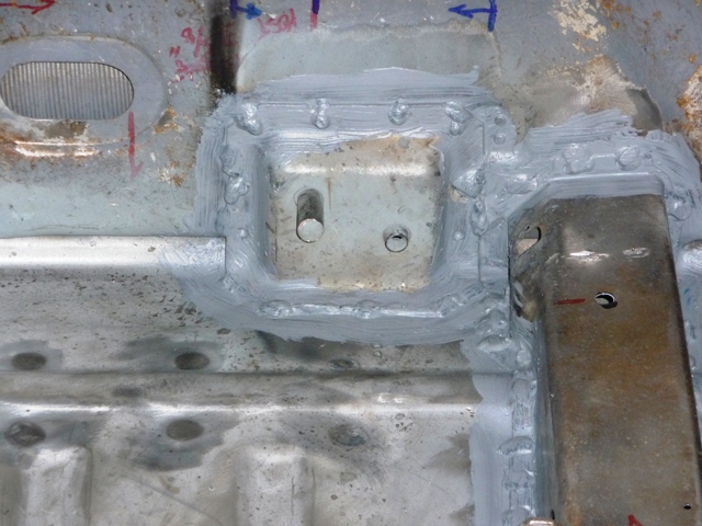

Zaney   Hell hole ready for seam sealer and 2K Primer. 16...   Mar 7 2010, 12:50 AM
Zaney   And the trunk firewall before being boxed out for ...   Mar 7 2010, 12:58 AM
