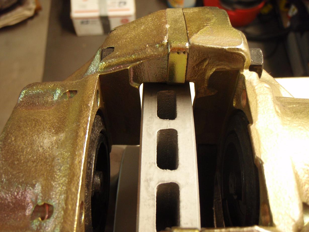

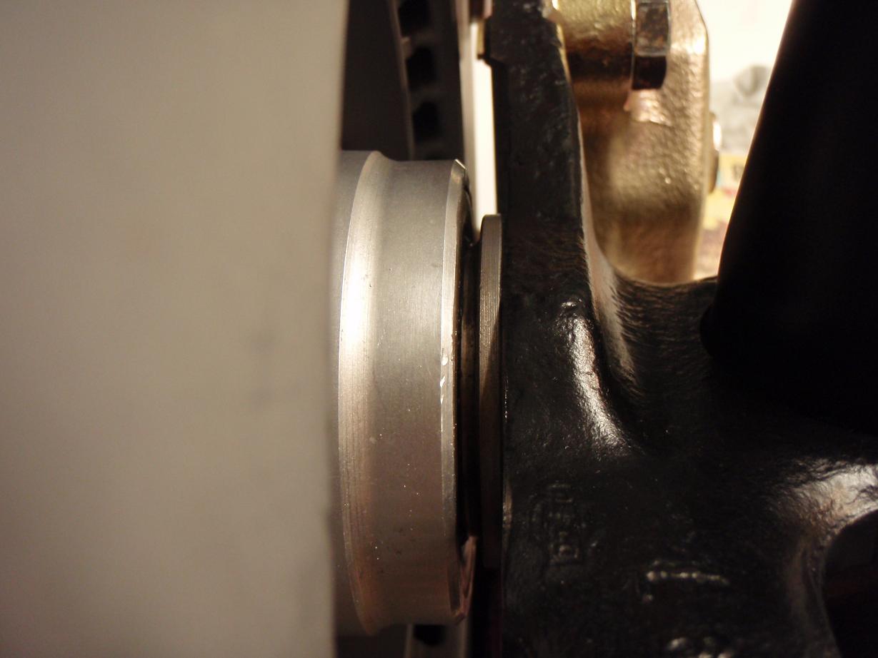

I pressed in the races from new bearings and adjusted the adjusting clamping nut on the strut housing spindle so that the washer just moves, as shown in the 911 Haynes manual. Can someone please confirm if the picture looks correct? It's the distance of the hub body and the distance ring. Is this correct? The reason I ask is that the caliper body does not appear 'perfectly' centered over the disk.
I installed the pads and they both clear the disk just fine...
Although I believe that I pressed the inner race all the way into the hub, I'd like some more sets of eyes to look at this before I tap the dust cap on all the way. Thanks.

MrKona   I pressed in the races from new bearings and adjus...   Apr 30 2009, 10:35 PM
MrKona   One more showing the assembly coming together. :D   Apr 30 2009, 10:36 PM
Jeffs9146   If it is not in all of the way the brakes would ...   May 1 2009, 08:25 AM
MrKona   If it is not in all of the way the brakes would...   May 1 2009, 09:49 AM
