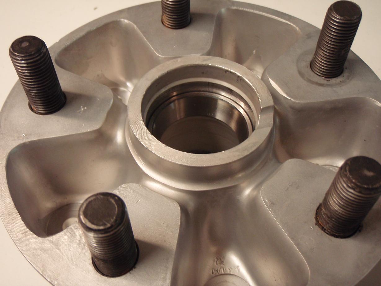

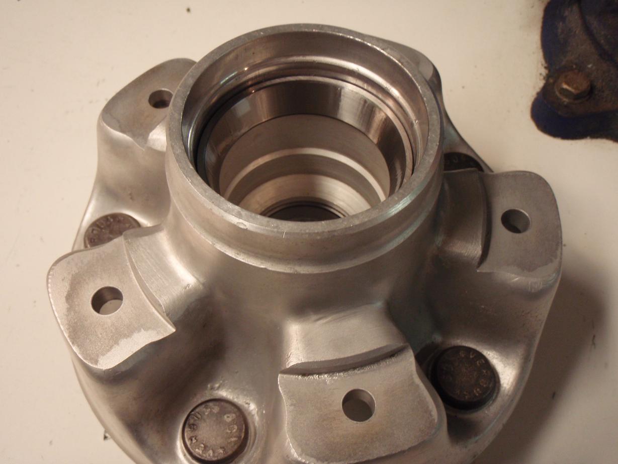

Assembly, part II tonight. Had to remove the hub and reinstall after attaching the brake dust shield. Once I put the dust shield on, I didn't have that strange space between the distance ring and hub like I did last night. Imagine that...
Per Haynes, torqued dust shield bolts to 18 ft/lbs. I used SS bolts and new wavy washers.
Also did a final visual check to make sure the new races were pressed in all the way. They were... Prior to pressing in the races, I heated the hubs in a 275 degree oven. I used a hydraulic press to install them, along with a correct size socket and large washers to rig up a way to press them in.

MrKona   I'm installing the rear bearings tonight. I st...   Apr 16 2009, 10:21 PM
charliew   If it's not too late. I have had real good luc...   Apr 18 2009, 09:47 AM
MrKona   If it's not too late. I have had real good lu...   Apr 18 2009, 01:25 PM
MrKona   I installed the hubs today using the same screw me...   Apr 18 2009, 01:29 PM
MrKona   Laid a couple washers on the tape. The washer was ...   Apr 18 2009, 01:30 PM
MrKona   The "screw mechanism." Put a light coat ...   Apr 18 2009, 01:31 PM
MrKona   And the final result!   Apr 18 2009, 01:33 PM

MrKona   I pressed in the races from new bearings and adjus...   Apr 30 2009, 10:35 PM
MrKona   One more showing the assembly coming together. :D   Apr 30 2009, 10:36 PM
Jeffs9146   If it is not in all of the way the brakes would ...   May 1 2009, 08:25 AM
MrKona   If it is not in all of the way the brakes would...   May 1 2009, 09:49 AM

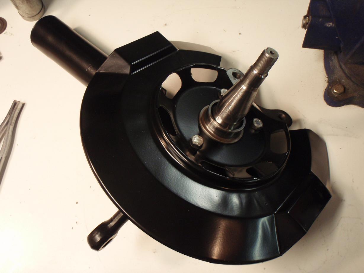

MrKona   Assembly, part II tonight. Had to remove the hub a...   May 1 2009, 11:23 PM
MrKona   Inner bearing in, and dust shield on, tapped in wi...   May 1 2009, 11:29 PM
MrKona   Disk ready for install of hub. New yellow zinc pl...   May 1 2009, 11:32 PM
MrKona   "Silver and Gold" :) Hub to disk nuts...   May 1 2009, 11:34 PM
MrKona   Ready for the dust cap. Per haynes, after installi...   May 1 2009, 11:38 PM
