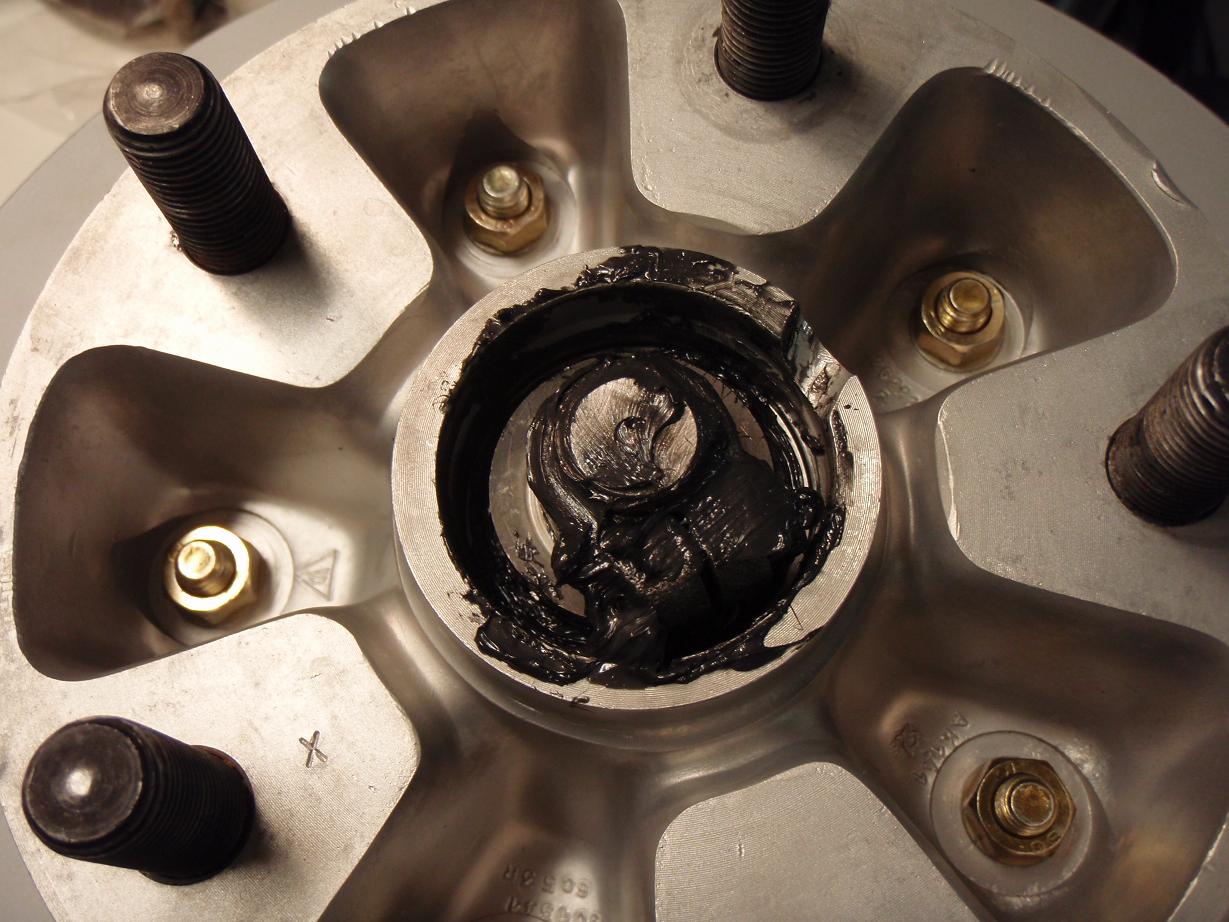

MrKona   Assembly, part II tonight. Had to remove the hub a...   May 1 2009, 11:23 PM
MrKona   Inner bearing in, and dust shield on, tapped in wi...   May 1 2009, 11:29 PM
MrKona   Disk ready for install of hub. New yellow zinc pl...   May 1 2009, 11:32 PM
MrKona   "Silver and Gold" :) Hub to disk nuts...   May 1 2009, 11:34 PM
MrKona   Ready for the dust cap. Per haynes, after installi...   May 1 2009, 11:38 PM
