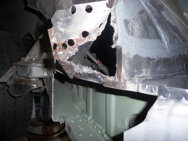

Zaney   Cut the fender to get at the wheel house and too...   Apr 24 2009, 10:13 AM

Zaney   After the passenger long was repaired on the inter...   Apr 24 2009, 10:23 AM
Zaney   Underneath, the seat rail reinforcements were repl...   Apr 24 2009, 10:29 AM
