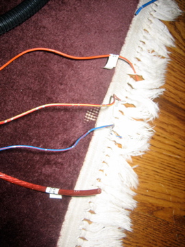

Hey guys-
I know it has been a while but I have been at school and finished finals last week and finally got back to working on my car. I decided to start the process of wiring the car. I had my wiring harness re-built by a company and have it back but I am having a little trouble figuring out what each connector goes too. There are also a few wires that need to be connected to the 914 that I need some help on. So, here are the pictures, hope you can help.
First, these are the 4 wires that need to be connected to the car (besides fuel pump and fans and gauge wiring). In order, left to right, the tags on the wire say:
Battery power (ok, i know this one)
Power during startup ( possibly for the starter motor connection??)
Ground in neutral
Iginition Power
The first 3 wires are about 20awg and the 'Ignition Power' wire is about 12awg

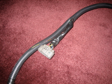

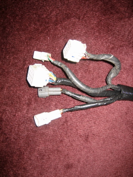

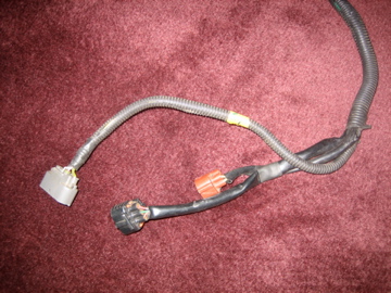

Next, these three pictures are of connectors that go into the engine bay.

TonyAKAVW   "Ground in neutral" can just be left ope...   May 28 2009, 01:12 PM
malaga_red75   Thanks Tony! I was hoping you would answer. ...   May 28 2009, 01:23 PM
TonyAKAVW   I left the starter connected to the 914 I believe....   May 28 2009, 01:51 PM
pktzygt   I left the starter connected to the 914 I believe...   May 29 2009, 03:48 PM
malaga_red75   I left the starter connected to the 914 I believe...   Jun 3 2009, 05:00 PM
charliew   I would think the 914 starter wire would go to the...   May 29 2009, 11:25 PM
TonyAKAVW   That should work fine. Now if I could only find t...   Jun 3 2009, 07:00 PM
