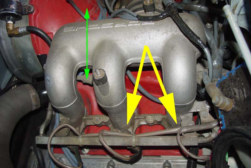

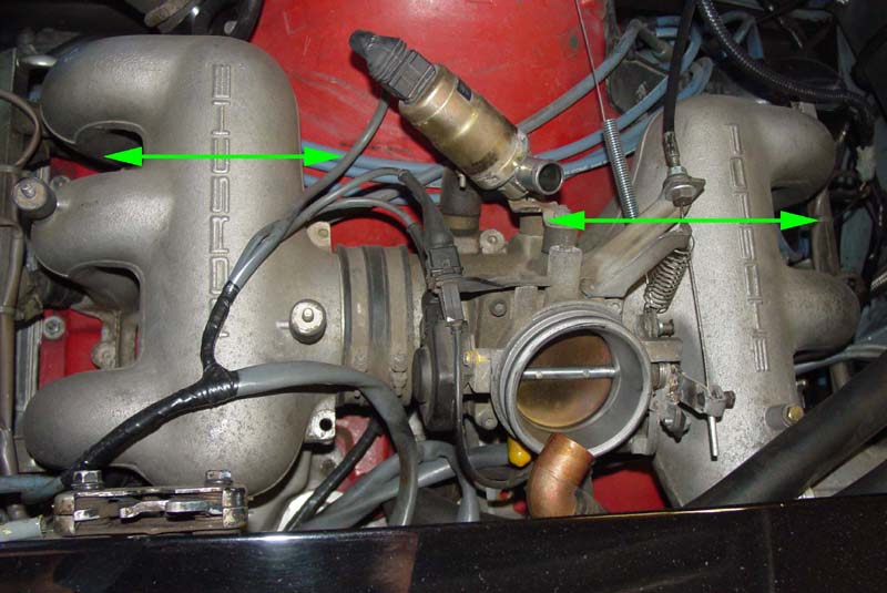

My initial plan was to use a common plenum with just one throttle body like on modern FI systems.
I took a 3.2L plenum and it's almost a perfect match to the intake runners pictured above. The bolt holes are only off by a bit.
The plan was to cut off two of the six runners from the plenum and weld it shut and use the stock 3.2L throttle body.
However, the 3.2L plenum proofed to be expensive, so i decided to try the individual TBs instead using 40 IDF webers ...
(IMG:style_emoticons/default/shades.gif) Andy
