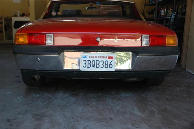

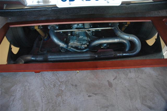

Here's mine:
Flowmaster muffler, custom exhaust. Exits the stock cutout on the valance. Nice piece of work form Rothsport Porsche here in Portland. I don't see how you can get the "stock" look with anything else.
