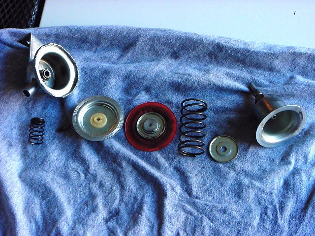

I got off from work early today and thought I would finish up my alluminum sunvisor mounts, I was wrong. I picked up an extra decel valve and decided to open it up. I plugged mine because It was all jacked up. I know most dont use their decel valve anymore, but thought if nobody had opened one up and posted it here before, this might help the ones that still have them.

In pieces:

415PB Diaphram was in good shape considering it is 30 ye... Feb 4 2004, 06:49 PM
415PB Top portion with the adjustment tube Feb 4 2004, 06:50 PM
415PB and back together again after a really good cleani... Feb 4 2004, 06:51 PM

busaslidr Why would one want to remove the decel valve, for ... Feb 4 2004, 10:07 PM
swood Is that an early decel valve? Mine on the '75 ... Feb 4 2004, 10:30 PM
72914S Decel valve? I thought that was for fuel pressure,... Feb 5 2004, 11:22 AM
Dave_Darling That is a decel valve, the FPR is similar. The 1.... Feb 5 2004, 11:49 AM
busaslidr So what does a decel valve do?? Feb 6 2004, 12:27 PM
! Keeps the throttle from slapping shut too fast, le... Feb 6 2004, 12:47 PM
swood So is it better to have than not have? Feb 6 2004, 06:49 PM
