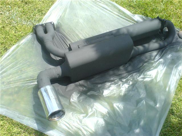

Has anyone tried running a 3rd generation RX-7 radiator set up in the 914? I am working on this right now and was wondering if anyone has had problems. I have a racing beat header and exhaust that will work for someone that is staying normally aspirated if anyone is interested. It is for a 13b and mounts to where the rear sway bar bolts mount.. I had it on my last 914 and it worked great.
You have any pics of the exhaust. What muffler if any does it use. Could you please post it here or send to me.

Rotary'14   another, There's going to be a pre-silencer an...   May 24 2005, 10:40 PM
