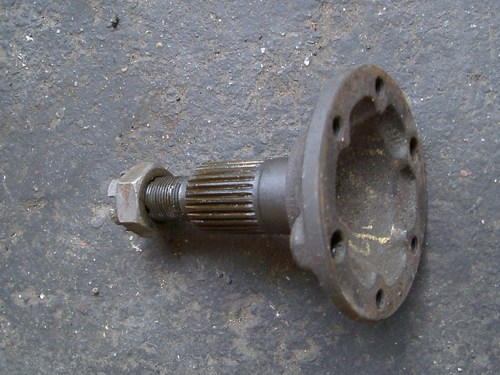

QUOTE(Project 6 @ Jun 23 2009, 02:22 PM) *
Here's a set from eBay.
Those don't look right! (IMG:style_emoticons/default/confused24.gif)
Here's a pic of my genuine 914/6 stub axles:

SirAndy   Here's a set from eBay. Those don't look...   Jun 23 2009, 04:55 PM
Richard Casto   Here's a set from eBay. Those don't loo...   Jun 23 2009, 05:02 PM

Lavanaut   Agreed with all above ~ those on eBay look wrong. ...   Jun 23 2009, 05:03 PM
Richard Casto   Agreed with all above ~ those on eBay look wrong....   Jun 23 2009, 05:14 PM
