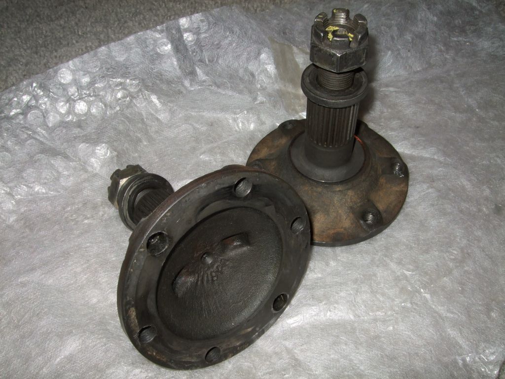

Agreed with all above ~ those on eBay look wrong. As I recall (not 100% here) the ones you want are '74-'86 or -'89. Here's an OEM set I sold recently for reference:
edit: i'm unsure re: years, see better info below

Lavanaut   Agreed with all above ~ those on eBay look wrong. ...   Jun 23 2009, 05:03 PM
Richard Casto   Agreed with all above ~ those on eBay look wrong....   Jun 23 2009, 05:14 PM
