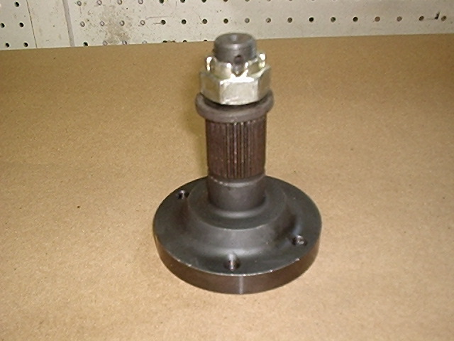

OK, so I'm ready to install the engine and found a surprise. The PO was going to install a later model trans. As such, they installed 915 style stub axles. The oem stubs are lost in space.
The existing stubs don't bolt up to the 914/4 axles and CVs I was going to use. The 2.0/6 "S" spec motor puts out about 140hp. So I wasn't worried about twisting them with high torque since I used this set up with a 3.0 in the past.
My questions is....are 914/6 AXLES which I might have access to, compatible with 915 sized CVs? FYI 914/6 CVs have been NLA for 20+ years....
Since I have the sub axles, can easily find drive flanges for the trans, I was thinking this would be an easy alternative. Does the 914/6 axle have the same spline count? 28 is what I've been told.
Simply using a 911 axle won't work, too long. Buying 914/6 stub axles is an expensive deal, $5-600. Mittelmotor and Otto....
Some good news, I HAVE been able to locate one stub axle...it will need a little machining as it's a bit corroded. But I'm looking for alternatives.
Anyone BTDT? Or even better....an orphan 914/6 stubbie?

Why not do it the simple way as the Dr says.? Get a set of repro stub axle from Otto's. They bolt to the 4 axle and mate to the -6 hub.
-6 axles and 4 axles are the same diameter and length. I cannot remember if the spline count for the axle shaft is different. -6 CVs have 6 bolts and no pins. -4 have 4 bolts and 2 pins. Both CV joints for the 6 and 4 are NLA.
-6 rear hubs and 69-73 911 rear hubs are the same part number. Stub axles for the 69-73 911 will fit in the hub. These hubs are 100mm. I do not know if the 100mm CV joint will fit onto the 914-4 shaft.

Rob-O 1167   I am 100% sure they're from a /6. Length is 2...   Jun 26 2009, 09:11 AM

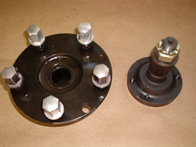

Project 6   Well the ones I got in the mail are the same size ...   Jul 1 2009, 09:44 AM
brp986s   Just dealt with this. Car is a '70 914-6 (#24...   Aug 30 2009, 10:07 PM
brp986s   Although the 911 and 914-6 axles are 25 spline, a ...   Aug 30 2009, 10:14 PM
brp986s   You can use a 100mm 911 stub in a 914-6 hub. Both...   Aug 30 2009, 10:19 PM
brp986s   To make it work, get 0.75 inch spacer. This one m...   Aug 30 2009, 10:24 PM
brp986s   wullah:   Aug 30 2009, 10:42 PM
mikez   First off, I wouldn't buy warm spit PMS. He d...   Aug 30 2009, 10:44 PM
brp986s   First off, I wouldn't buy warm spit PMS. He ...   Aug 30 2009, 11:02 PM
Eric_Shea   Buying the proper length axles is better IMO. ...   Aug 31 2009, 12:43 AM
