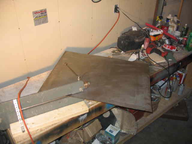

QUOTE(maf914 @ Feb 7 2004, 05:09 AM)
Rich,
On your new firewall, how did you form the stiffening ribs on the flat panel?  I assume there a machine that does this?
Mike
I have a bead roller. It's a set of upper and lower dies that press a step in the panel There are many different shape dies.
the photo doesn't show the crank handle on the left.
