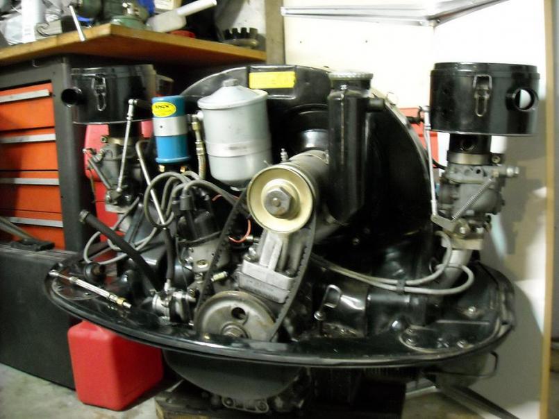

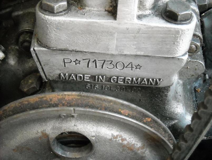

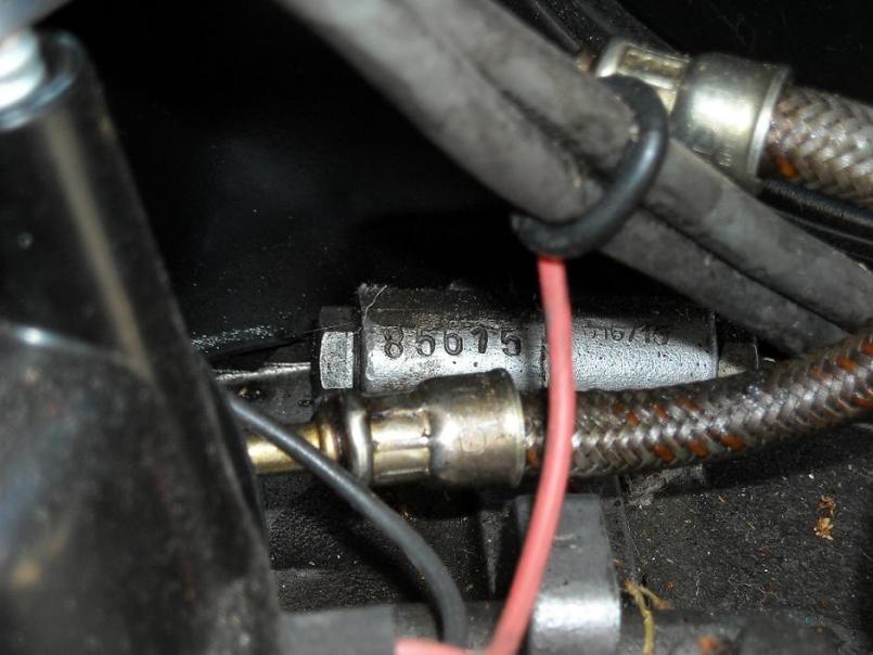

Where do you find the "three pieces" that have the number on them? Someone mentioned that if they have all three matching numbers the engine becomes a bit more valuable? Here are some pics:

Nor.Cal.914 The engine should be up on a stand later today so ... Jul 10 2009, 03:57 PM
mikez Looks in good shape....post an ad over on the Regi... Jul 10 2009, 04:00 PM![]() ![]() |
