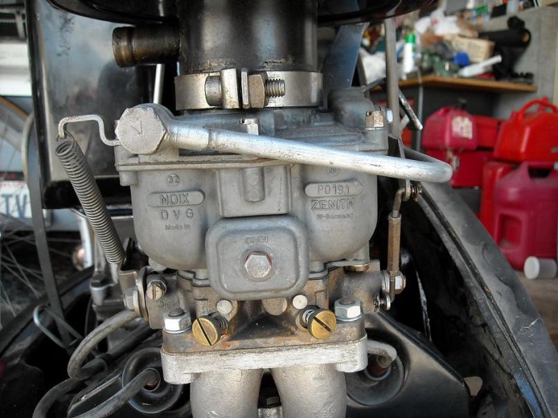

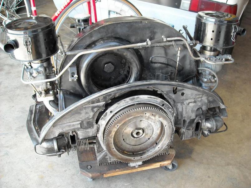

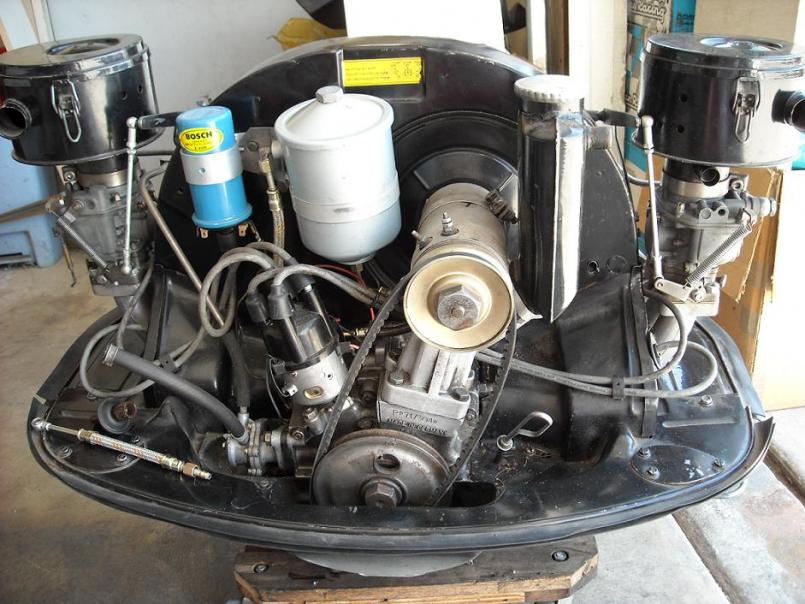

The engine should be up on a stand later today so I can get some better pics. Here's some more:
Attached thumbnail(s) |
