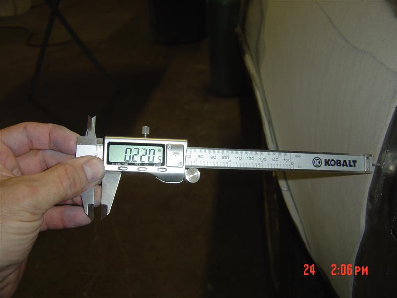

Mo. Cut the existing mud down as much as I could. Much better but still thick (IMG:style_emoticons/default/dry.gif)

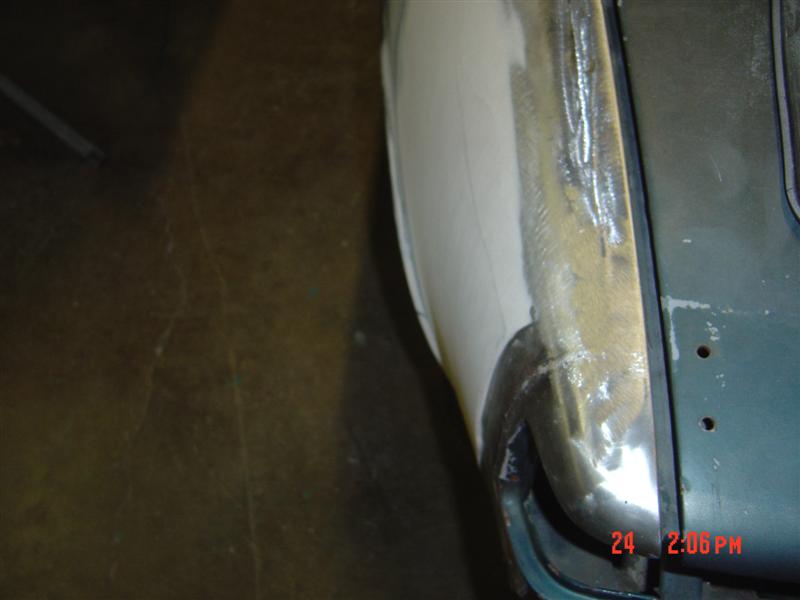

scotty b   Got a little done yesterday before the welder went...   Jun 12 2009, 03:06 PM
kwales   Holy crap... With .319 inch worth of mud, you sho...   Jun 12 2009, 05:40 PM

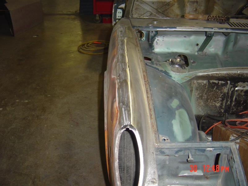

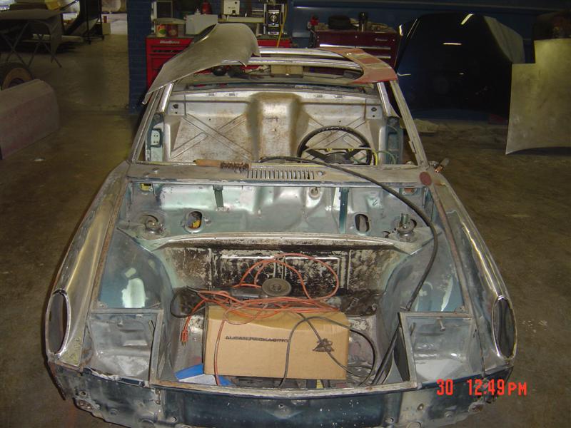

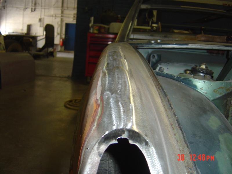

scotty b   Little more progress in the last few weeks. I actu...   Aug 1 2009, 10:25 AM
scotty b   Don't know why but I like this shot for some r...   Aug 1 2009, 10:34 AM
