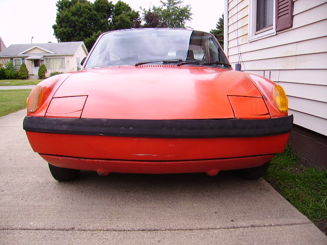

well, you will need to replace the crank and rods to use 2.0L pistons, assuming the 1.8 is still a 1.8, and wasn't rebuilt into something else. if they are 2.0L pistons the pin height is for a 72mm(2.0) crank, with 2.0 length rods, the 1.8 and 1.7 used a 66mm crank and different rods with different pins. if you are going to build the engine, I suggest getting Jake Raby's build video and studying it like your new favorite porno. you can get it at type4store.com if my engine was in a box of pieces I'd be worried too... (IMG:style_emoticons/default/biggrin.gif) but don't worry, with jake's video, and us here... we'll help I really appresiate your help and advice. I will check the block and get a new crank and rods if needed. I will also get the vidio. again thanks. I wanted to show you the front of this 914. I have been having a hell of a time figuring out how to download photo's to the site I'll give it a go. |

![]() well, you will need to replace the crank and rods to use 2.0L pistons, assuming the 1.8 is still a 1.8, and wasn't rebuilt into something else. if they are 2.0L pistons the pin height is for a 72mm(2.0) crank, with 2.0 length rods, the 1.8 and 1.7 used a 66mm crank and different rods with different pins. if you are going to build the engine, I suggest getting Jake Raby's build video and studying it like your new favorite porno. you can get it at type4store.com if my engine was in a box of pieces I'd be worried too... (IMG:style_emoticons/default/biggrin.gif) but don't worry, with jake's video, and us here... we'll help I really appresiate your help and advice. I will check the block and get a new crank and rods if needed. I will also get the vidio. again thanks. I wanted to show you the front of this 914. I have been having a hell of a time figuring out how to download photo's to the site I'll give it a go. |

john914/4 [quote name='john914/4' post='1199580' date='Aug 5... Aug 7 2009, 03:55 PM
tat2dphreak I think you are talking about the stock Valance be... Aug 7 2009, 04:08 PM

Pat Garvey Where the heck did that front bumper come from?
Pa... Aug 7 2009, 05:47 PM
