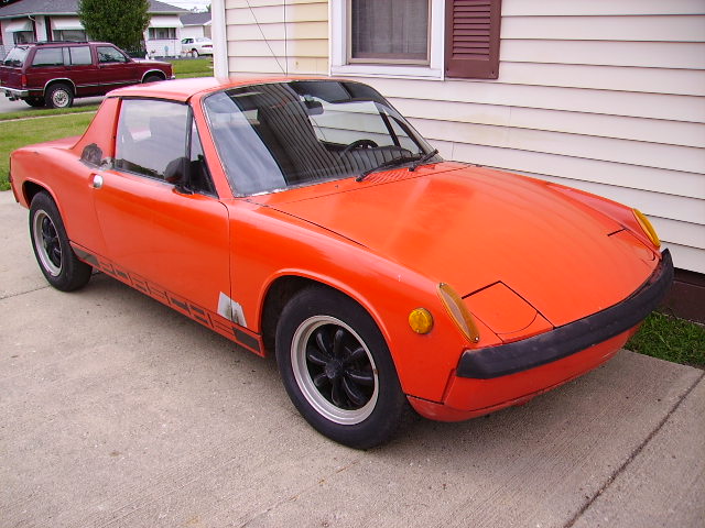

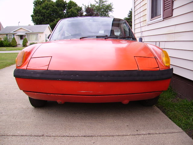

I wanted to show you the front of this 914. I have been having a hell of a time figuring out how to download photo's to the site I'll give it a go.

I think you are talking about the stock Valance being rounded, where others are flat...
others have gone to aftermarket air dam, or LE-style Valance
I think your 914 looks awesome, btw!

Where the heck did that front bumper come from?
I kinda like it, never seen one like it tho

thanks. the front valance was on the car when I purchaced it. it is unusal as I have never seen one. I don't know if I will keep it on as I like the style on my 70 parts car. I may put the rear valance from my 70 on as well. it looks pretty cool. but there is a factory hole on the drivers side and it appears that there is some sort of electrical hook in? me and my brother can't figure that one out. maybe a battery connection. I don't know. again thanks for you valuble knowledge with my car. I am also thinking of putting the 1.7 from my 70 in it to get it on the road while i rebuild the 1.8 over the winter. again thanks for all your help.

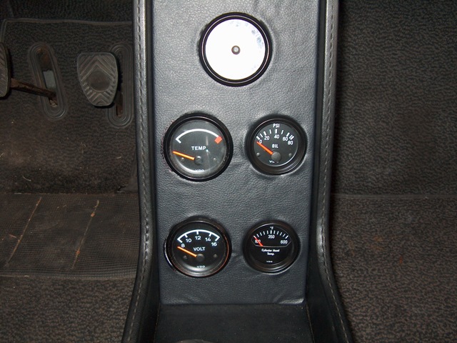

I really appreciate all your help and I would like to ask another question. on my center console on the floor there is a VDO boost, press. gauge. I have not seen this in any other 914 so far. what was the reason for the gauge. It apears stock. thanks.
tat2dphreak
dunno. stock console had oil temp, voltage and a clock.
I pulled out the voltage and clock on mine, for oil pressure and CHT,
maybe that is an oil pressure gauge? or if the person was going to turbo the car, they may have indeed wired a boost gauge.

thanks for the reply. I believe I will change mine as well. need better info then those gauges. again thanks.

I used this oil temp gauge
this oil pressure gauge
be sure and use the dual sender, so you will have the stock light + the gauge
I also used the CHT from VDO, but at this point I can't recommend it since I can't get the F'n thing to work right.
edit: almost forgot, you will need the little adapter rings, these are slightly smaller than stock. the adapter rings can be had from egauges.com cheaply or you can make your own
