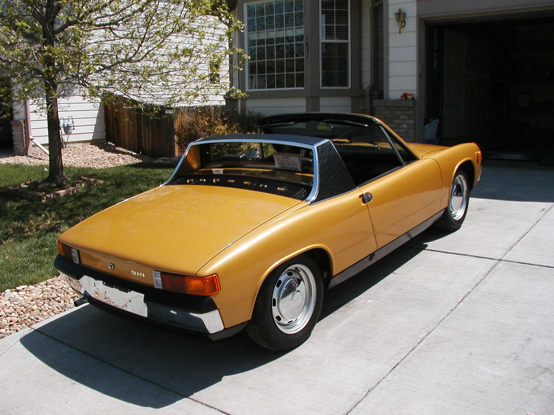

Cool, another Gold one, to bad it was color changed. Seems like a high number of gold, ravenna green, and orange cars were color changed.
Pic of my old Gold car the "Dijon Bomb"

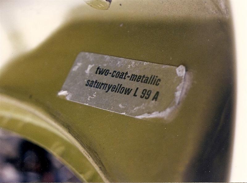

jt914-6
post Aug 5 2009, 12:34 PM
Posts: 1,787
Joined: 3-May 08
From: Bryant, Arkansas
Member No.: 9,003
Andy,
Here's a pic of my car's color tag. I see it is called Delphi Green Metallic. As you can see what it is called on my car. BTW, quickly changed the color to Ocean Blue Metallic (3AY).

QUOTE(Ferg @ Aug 5 2009, 10:06 AM) *
really nice car. I will return mine to its original met. gold. I met a friend at a car show a couple weeks back that had a green 914 as you mentioned. his car is really nice. he was from germany and living over here now.

QUOTE(jt914-6 @ Aug 5 2009, 10:34 AM) *
http://www.914world.com/bbs2/index.php?act...mp;sortby=sCode
L99A Delphi Green Metallic (Saturngelb-Metallic)
From the Page:
The German color names are added in (small print) where available.
Saturn Yellow Metallic is what it's called in German.
(IMG:style_emoticons/default/shades.gif) Andy
