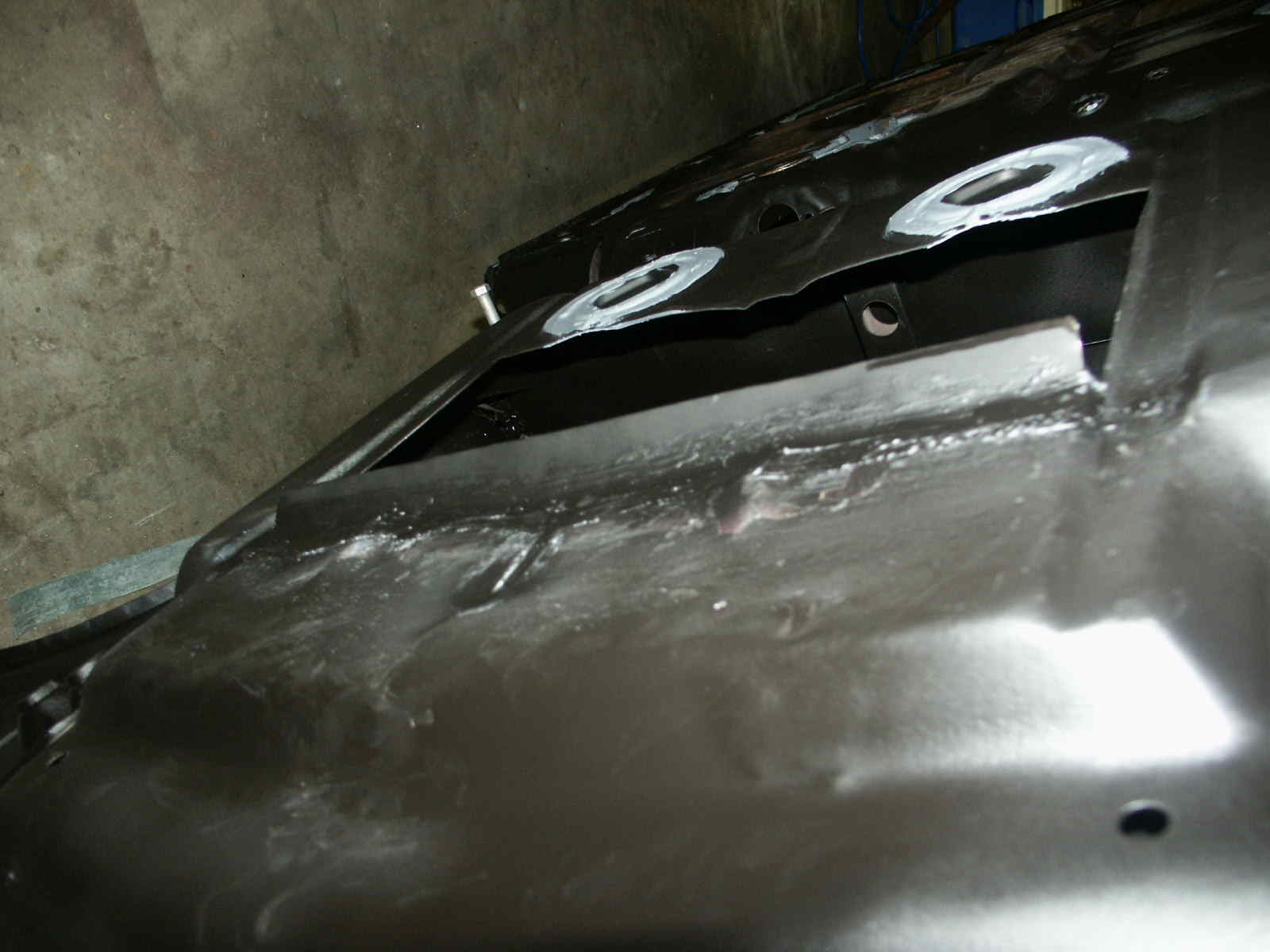

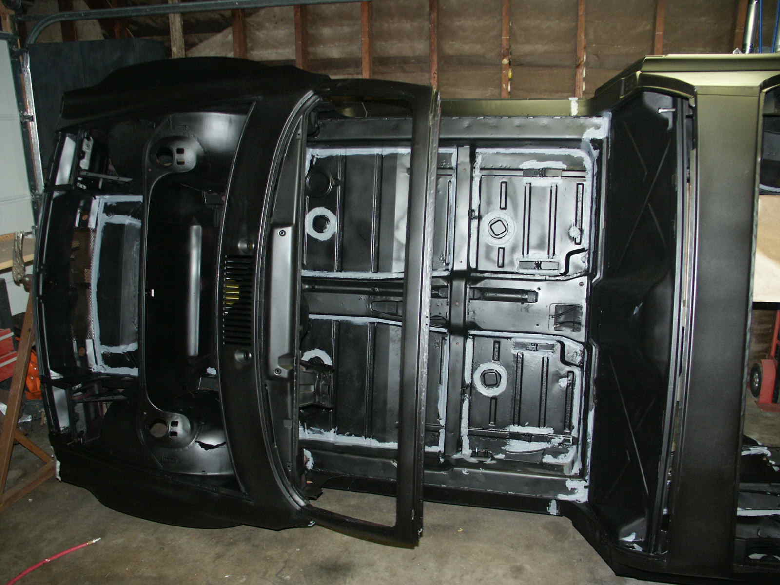

Seam sealer
More

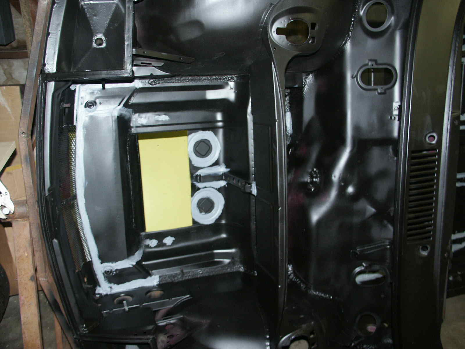

Underside of front trunk with oil cooler cut out, I added the additional flap you see to create a low pressure pocket where the hole is to suck out air for better cooling, a few GTs had this same style flap.

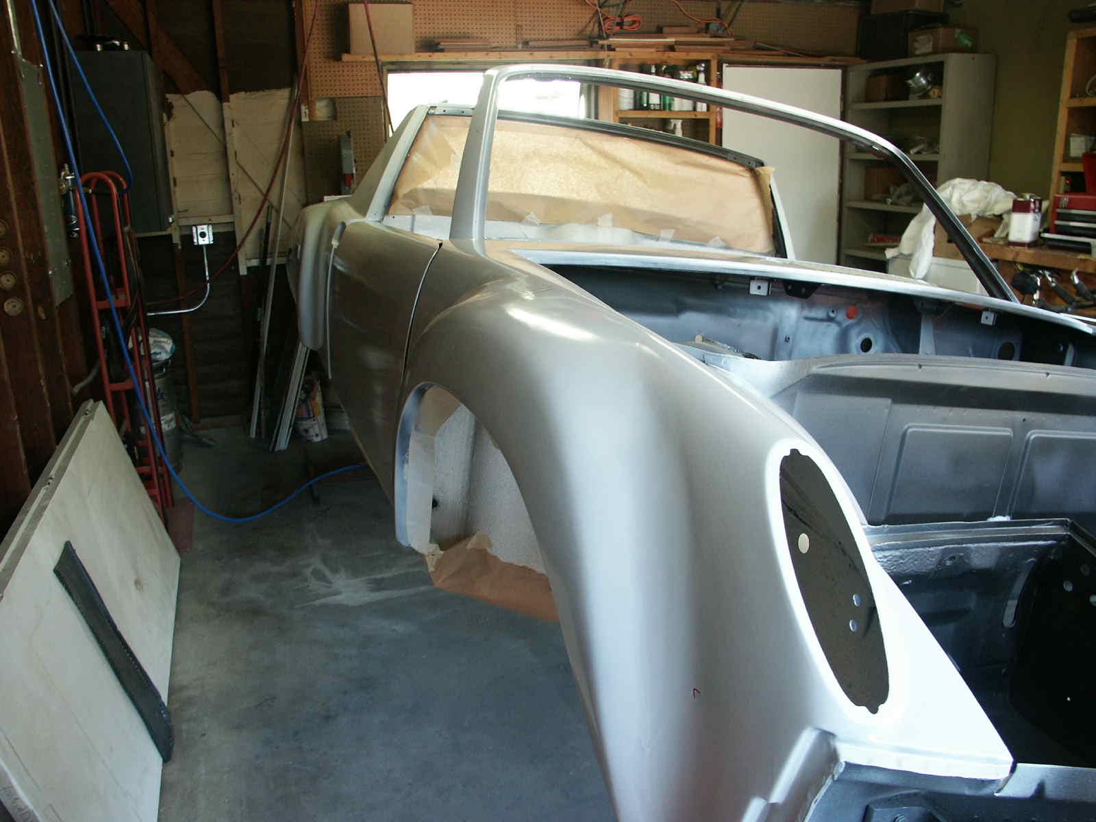

First coat of primer
