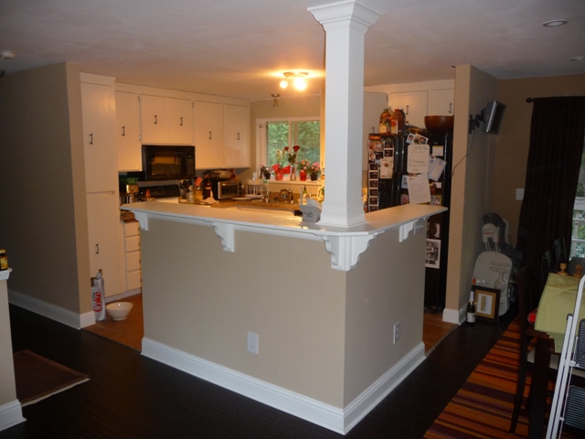

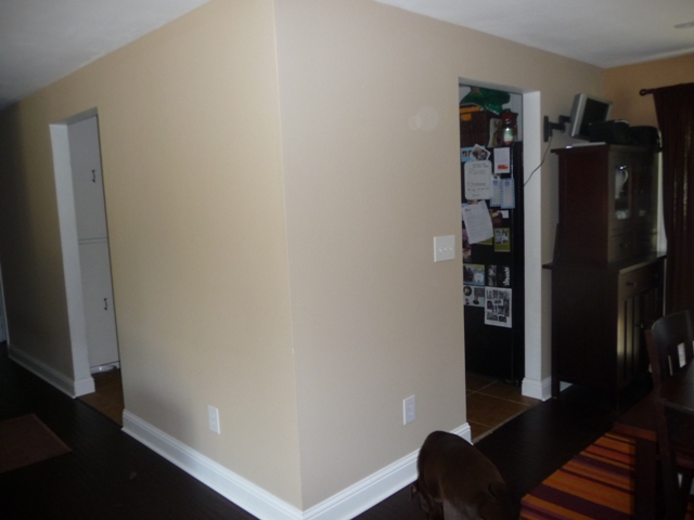

My wife decided she wanted to cut open the wall in out kitchen to make it more open (when she was 39 weeks pregnant!) So, nothing like a deadline to get a project done!
We went from this
To this in two weeks!
Oh ya, Little Miss Sydney was born twelve weeks ago right in the middle of the house project!!! (IMG:style_emoticons/default/screwy.gif) (IMG:style_emoticons/default/cheer.gif)
Luckily, my mother-in-law stayed with us for 10 days in order for me to wrap up the messy project!
